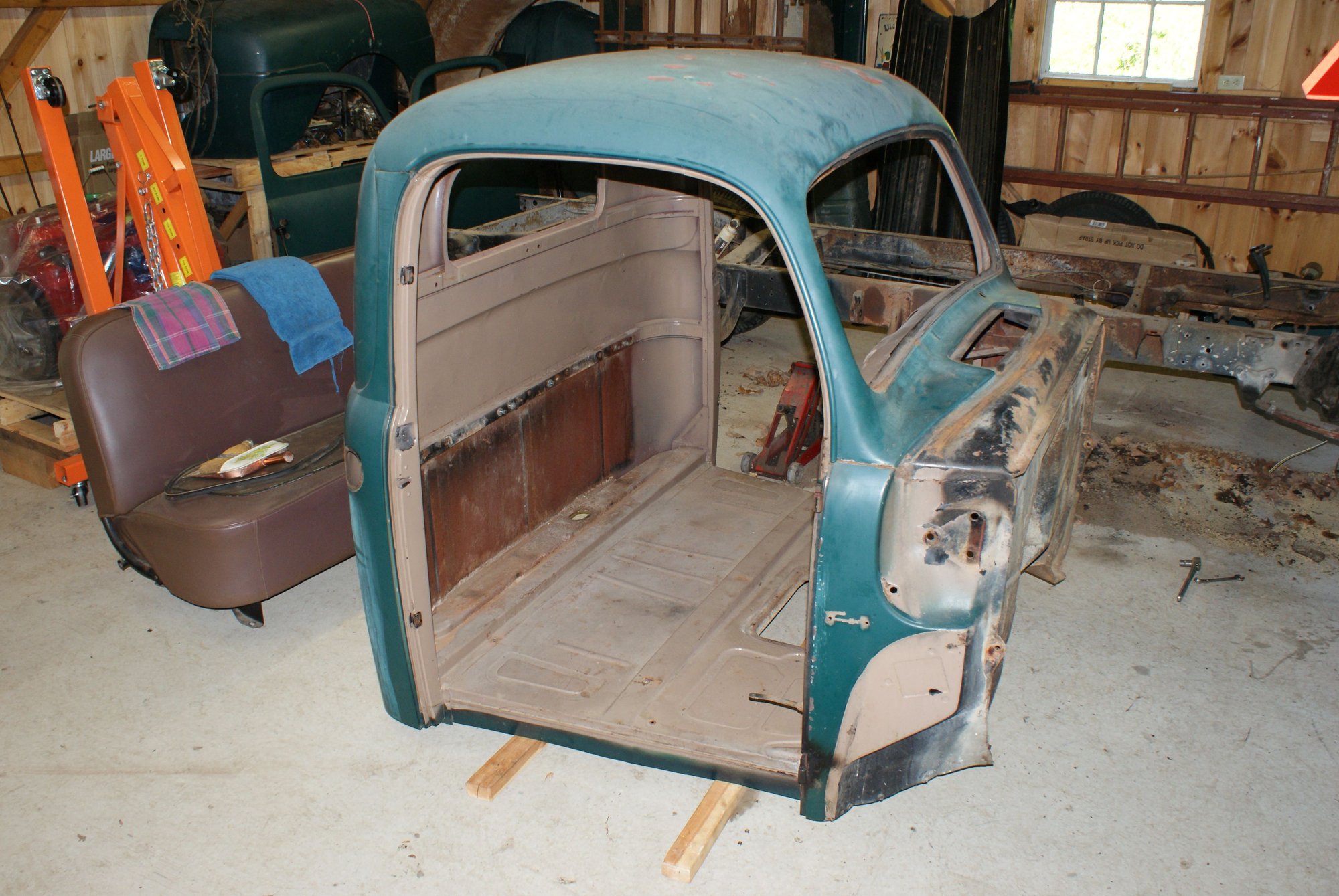

On and off and only takes minutes..

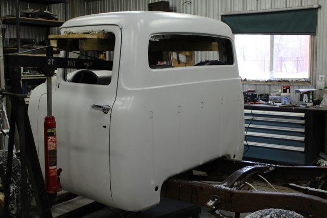

Here is a good picture from that thread, but instead of chain use tie down straps. With straps it will be easier to adjust them to keep the cab level.
It's quite a bit heaver in front.

you also need to have enough room to roll the cab over to the side of the frame or the frame (on wheel dollies) from under the cab. With the cherry picker there you can't roll the frame straight out
I have to work alone most times... My cherry picker is my best shop friend.
I'd also knock up something like this to move the cab around in your small shop
https://jniolon.classicpickup.com/cabdolly/cabdolly.htm
it's easier with the doors off too, but you can do with them on. I used chains to the points on the floor,but have also used a beam thru the top. Wouldn't recommend a strap around the roof. It rolls the drip rails in. Ask me how I know.

Two 2x4"s and a couple of friends will do it. Two people slide the lumber under the cab and lift, the third person rolls the chassis out from under the body.

I did it John's way. The cab was very stable. No swinging around.
The nose sat down first, which allowed me to align everything before dealing with the rear cab mounts.

An engine hoist and two 2x4's...don't get much easier than that. And when you move on to another project it works for that as well...

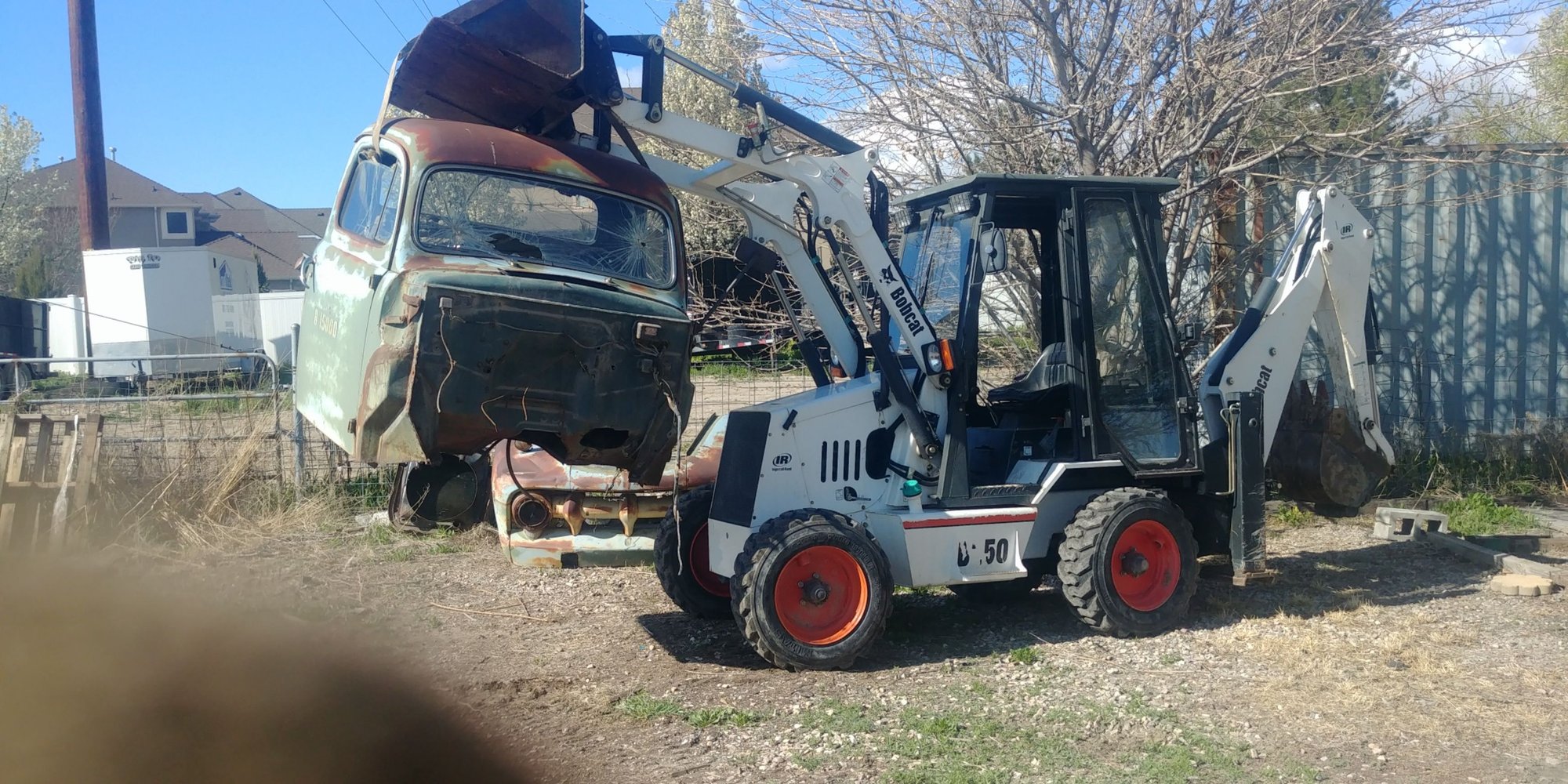

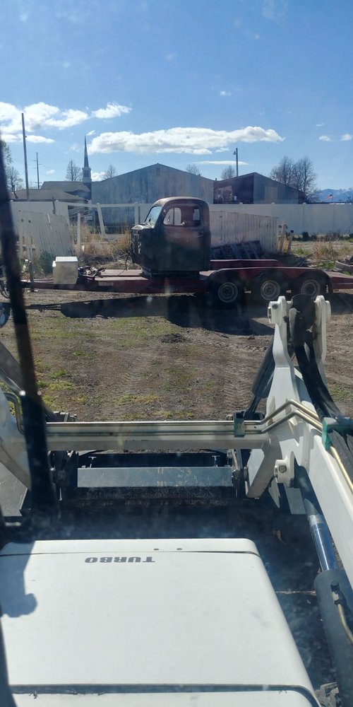

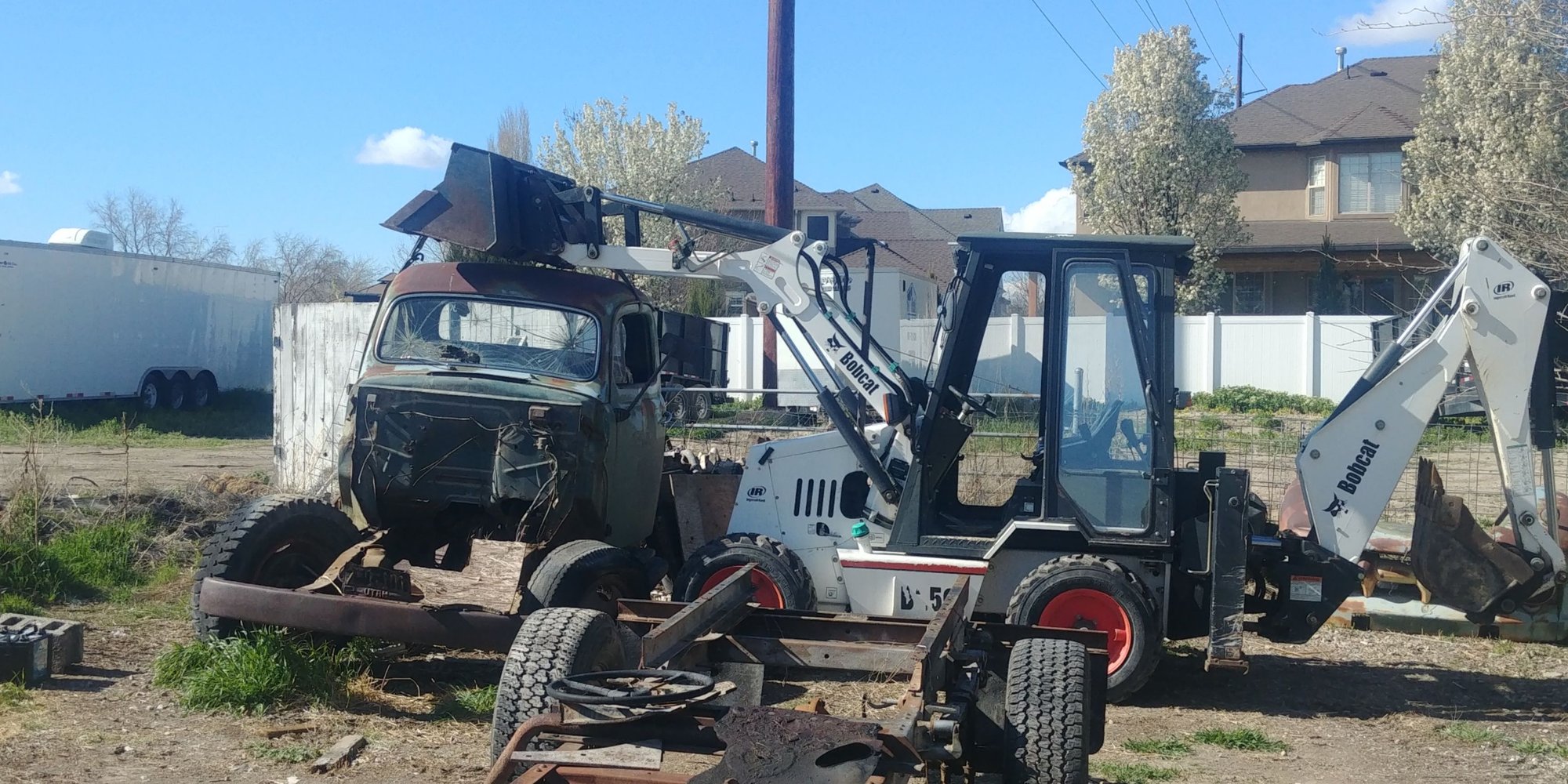

I've done numerous cabs with the cherry picker and lumber through the doors but was usually done on concrete, I have done a few on dirt and raised the cabs up and rolled the frame out from under it.
but today I cheated on the 51 F6 that I'm parting out. finally cleaning up the storage yard...
