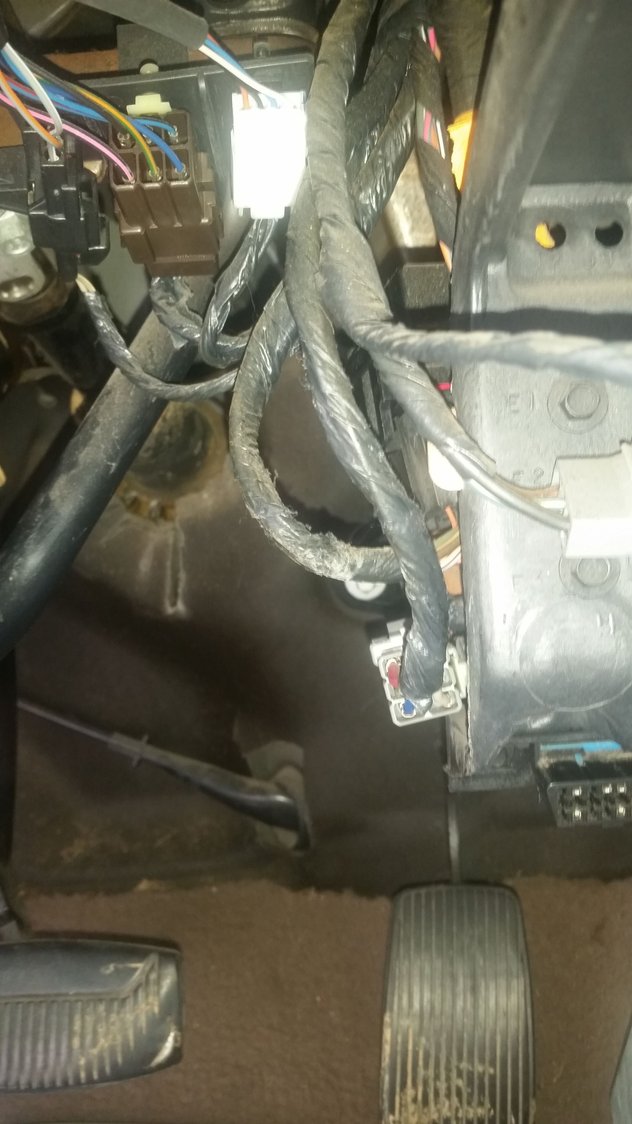

Blower motor resistor
Hamfisted, I do not have something that looks like the picture you sent. I tried to download a good pic. I am a rookie to this site.
Under driver side dash

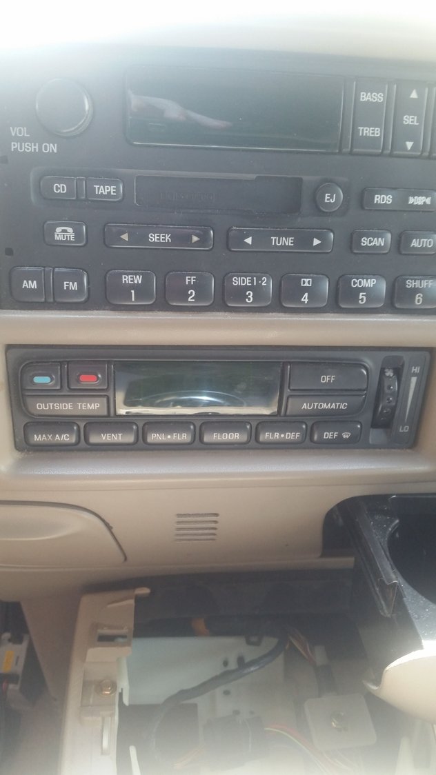

Did you look up against the air box with a flashlight ? What's that brown circuit board there in the back of your pic ? You dfanidn't show a pic of the HVAC head unit in your Expy, maybe you don't have the EATC system and not the black fan speed control module.

projectSHO89's Avatar
projectSHO89
Joined: Jan 2004
Posts: 19,762
Likes: 1,079
From: St Louis
He's on the left side of the steering column, not the right side.
Look above the gas pedal!

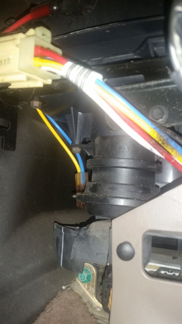

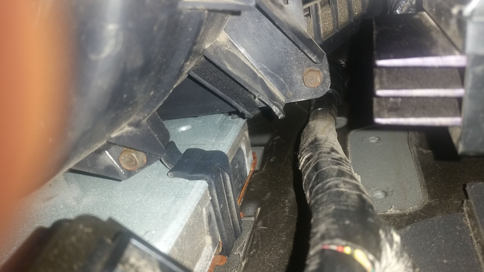

More pics under dash. I found something that could be it on the passenger side that looks like what they call a blower motor speed control.
Dash control
Driver side behind center console
Driver side
Passenger side by kick panel under glove compartment

According the the factory service manual, it's buried up behind the glovebox. See those three vertical fins in your last photo? Looks like the back part of the BSCM.
Attached are factory instructions on replacing it.

Blower motor speed control
Thanks guys. After removing the various panels I finally found it behind and above the glove box. I now need to find out how to test it. I didn't find any burnt wires. If anyone knows how to test it when it is off,I would appreciate it. Or do I have to reconnect it to test it. It does look like the picture but I wasn't expecting to a circuit board on the one face.

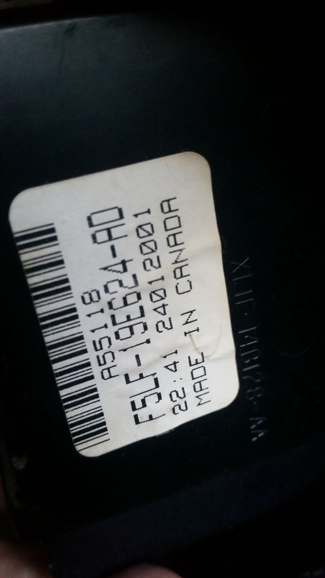

"01 Expedition Eddie BauerBlower motor speed control
I am looking for a blower motor speed control.
I just took this out of my 2001 Exp and looking for a used one. Also I am trying to find out how to test it.
Is the Part No. F5LF-19E624-RD? If so, does the replacement have to be those exact numbers including the RD at the end. What is A55118?

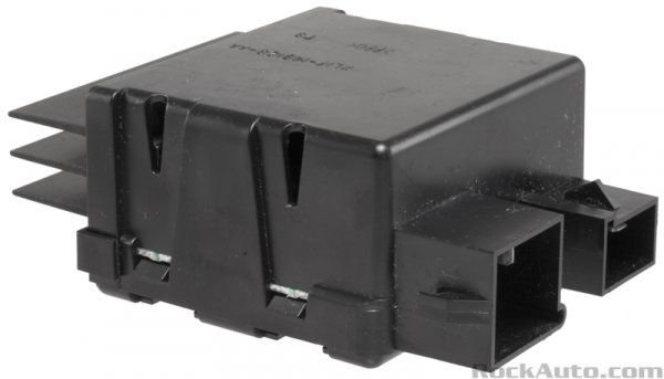

Old Aug 18, 2019 | 08:46 AM
Hamfisted's Avatar
Hamfisted
Joined: Feb 2003
Posts: 877
Likes: 27
From: South Florida
Rock Auto has a few to choose from. Expedition Blower Motor Module at Rock Auto
