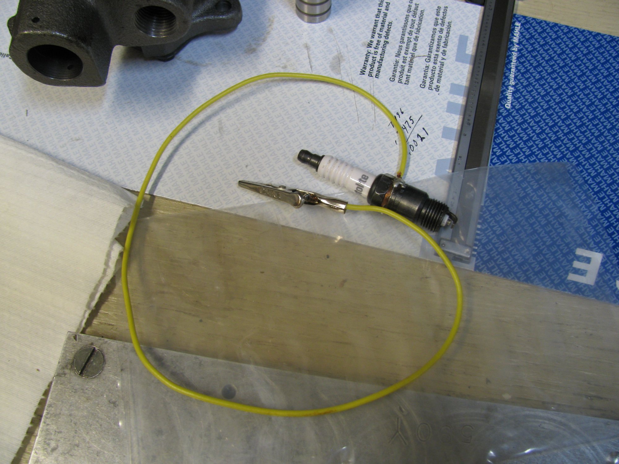

Easiest way to check spark quality is to get a new spark plug an make one of these. Just unplug a wire, plug in the test plug ground it and start it up. It will run just fine on 7 cylinders and you won't have to say bad words.
Since no volunteers...
Good spark, all cylinders
