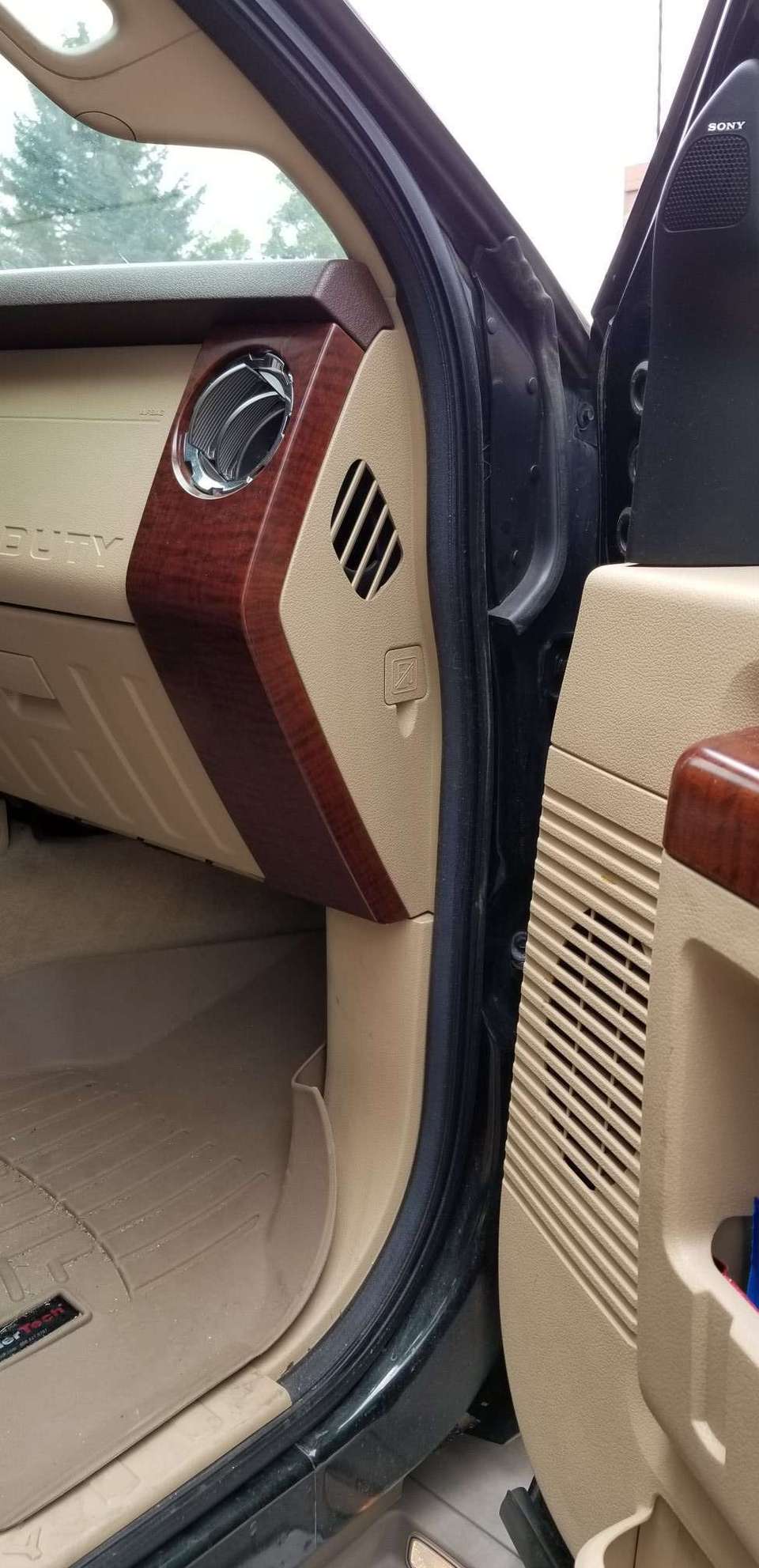

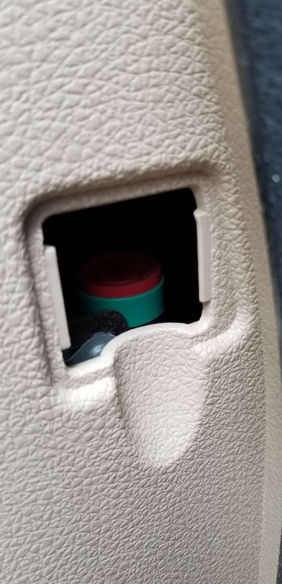

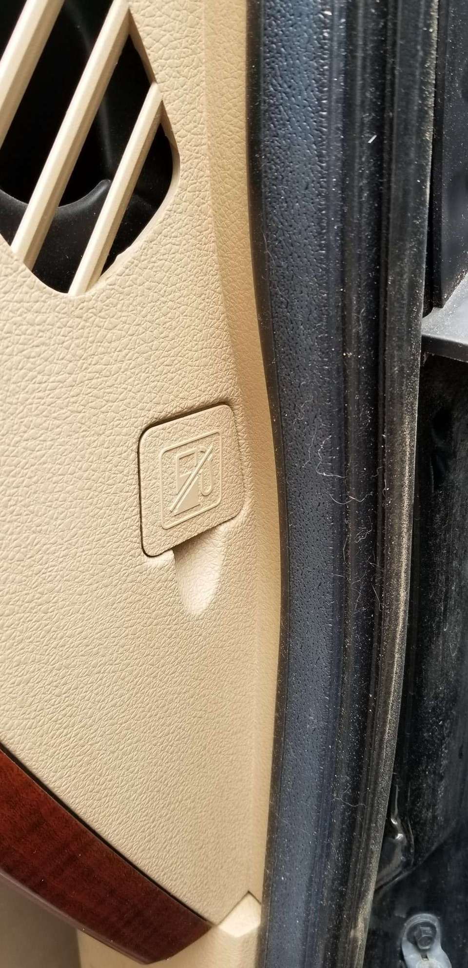

2014 F250 King Ranch 6.7 Diesel. I was searching for an appropriate place to pass a hotwire from the cab to the engine compartment when I saw this on the passenger-side dashboard. A little door with a "no fuel" icon. When I opened it, it looks like there's a little valve of some kind in there. See photos attached, zooming in from far out to close up.

I can't see in there but I'll take a stab...could it be the reset for the fuel pump--the one that would be tripped in a major impact? or is that just on gas vehicles?

Well, I didn't even know such a thing existed. But like an idiot, I stuck my finger in there and pushed the top of it and heard a CLICK. So I guess I should go out there and start it and drive it around the block and make sure I'm not running out of fuel.

Yes - that’s the fuel reset. If you ever can’t start it after a hard hit, check to see if that tripped and reset it.

When it needs to be rest, the button will pop up. An impact, from something like a collision will cause it to trip.

That is the fuel inertia switch that has been present on every Ford vehicle equipped with fuel injection utilizing an electric fuel pump since the 80s, designed to open the fuel pump circuit during impact or collision.

That is s a much better location and identification than the older vehicles have! Be thankful. It is the first thing to check if your truck has no fuel pressure.

Used to tap the support in the trunk of our town car when unloading luggage during traveling. Kind of a fuel shut off theft prevention. I believe the newer cars and trucks illuminate warning lamp when tripped.

It only resets the fuel pump shut off when it actually got shut off. When the shut off didn't shut off, pushing the button will do NOTHING.
And when a fuel pump does get shut off, you only get seconds of run time. You will know for sure if there is no pump running. This aint your grandpa's boatmotor that runs for 20 minutes after shutting off the fuel.
