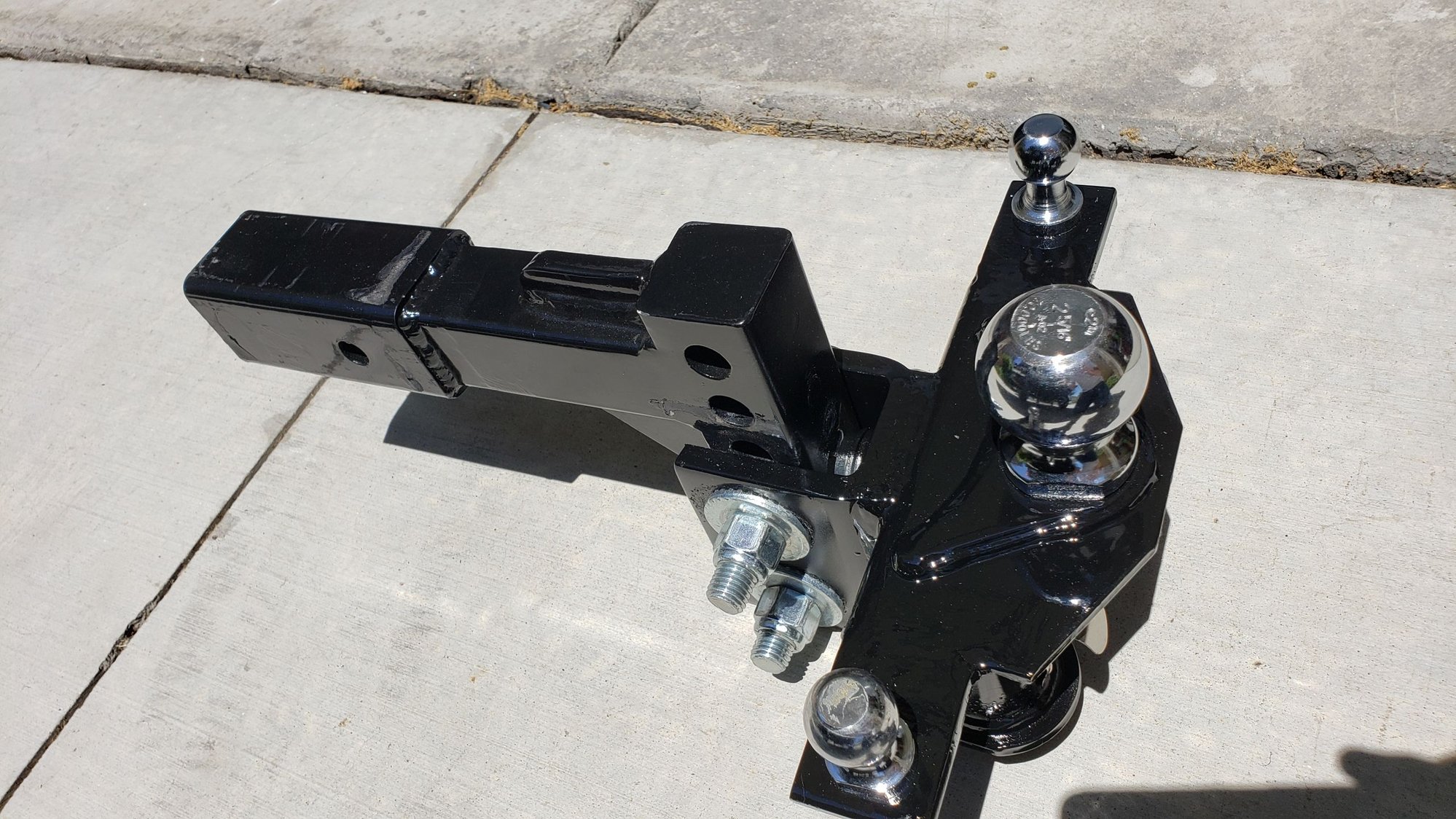

Recently purchased a F350 coming from a F150- we plan on a bigger camper 5th wheel in the next year. In the meantime I'm setting up my 24 foot travel trailer and Equalizer hitch for the 350. I purchased a 2 1/2 to 2 reducer and did a 180 on the shank. My ride measurements look good. I'm worried the shank is not going far into the receiver. Anyone here with a similar hitch setup. Thoughts on my pics?

You could always redrill the sleeve if you wanted to but I'd just leave it as-is. I have a similar setup but I welded the sleeve to the shank to cut down on the slop. I also use a hitch clamp which reduces the slop to zero.
On edit, is that a detent on the sleeve? Looks like that should go right up to the receiver to reduce the play. You could rotate the sleeve 90°, run the sleeve tight up against the receiver, and mark the new hole location for drilling.

If it was me, I wouldn't be too worried about the depth the reducer goes into the receiver. Do keep an eye on the pin hole in the receiver for wallowing out. Use of the reducers seems to be the source for the hole turning from a circle to an oval. It may be more likely on the 3" receivers that are using both reducers to get down to 2" shanks.
I started with using both reducers so I could use the hitch that came with my trailer. After one trip, I switched to a WDH that had a shank sized to fit my receiver so I no longer had to use the reducers. Less slop, less noise, no wallowing of the pin hole.
