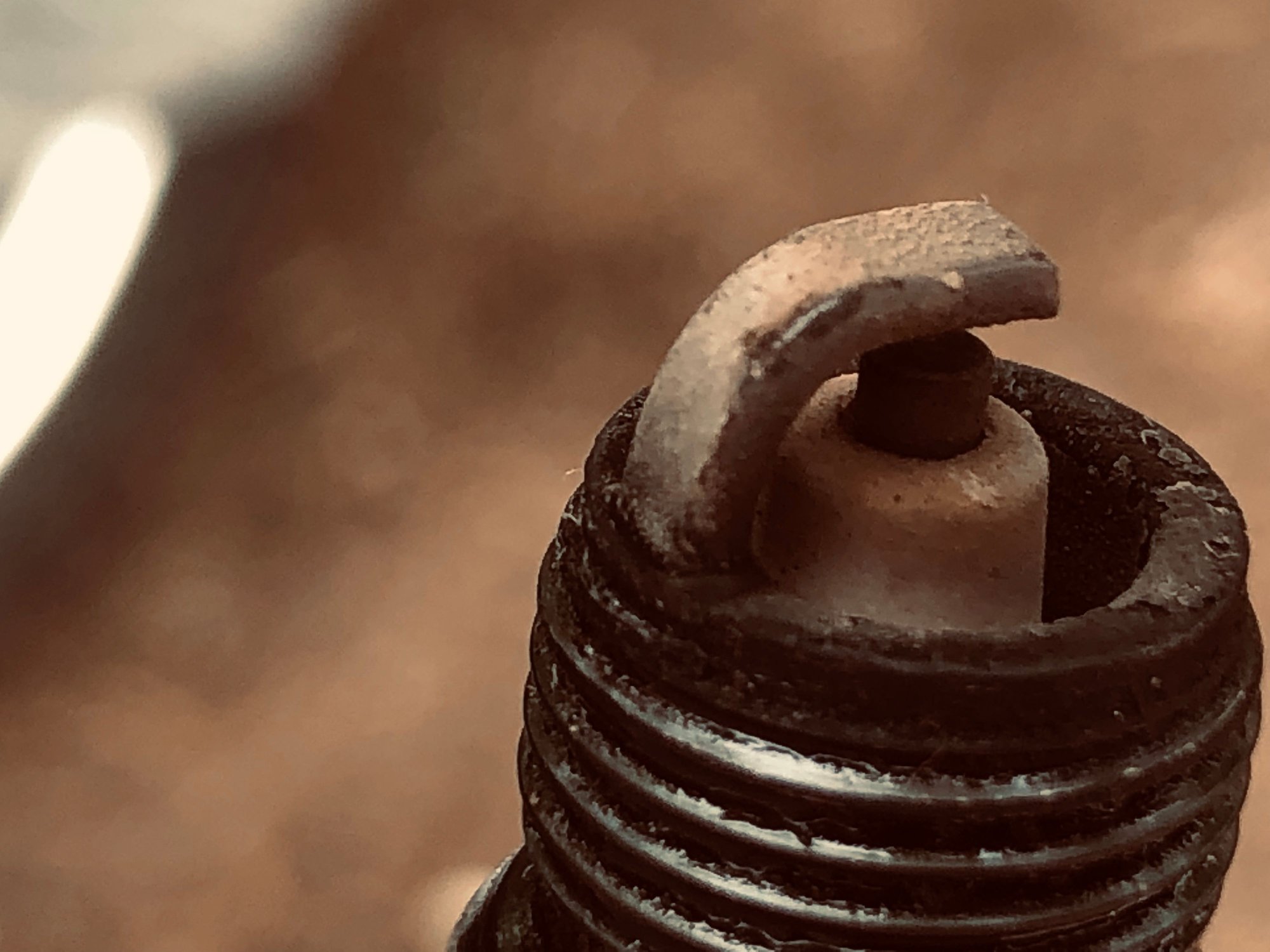

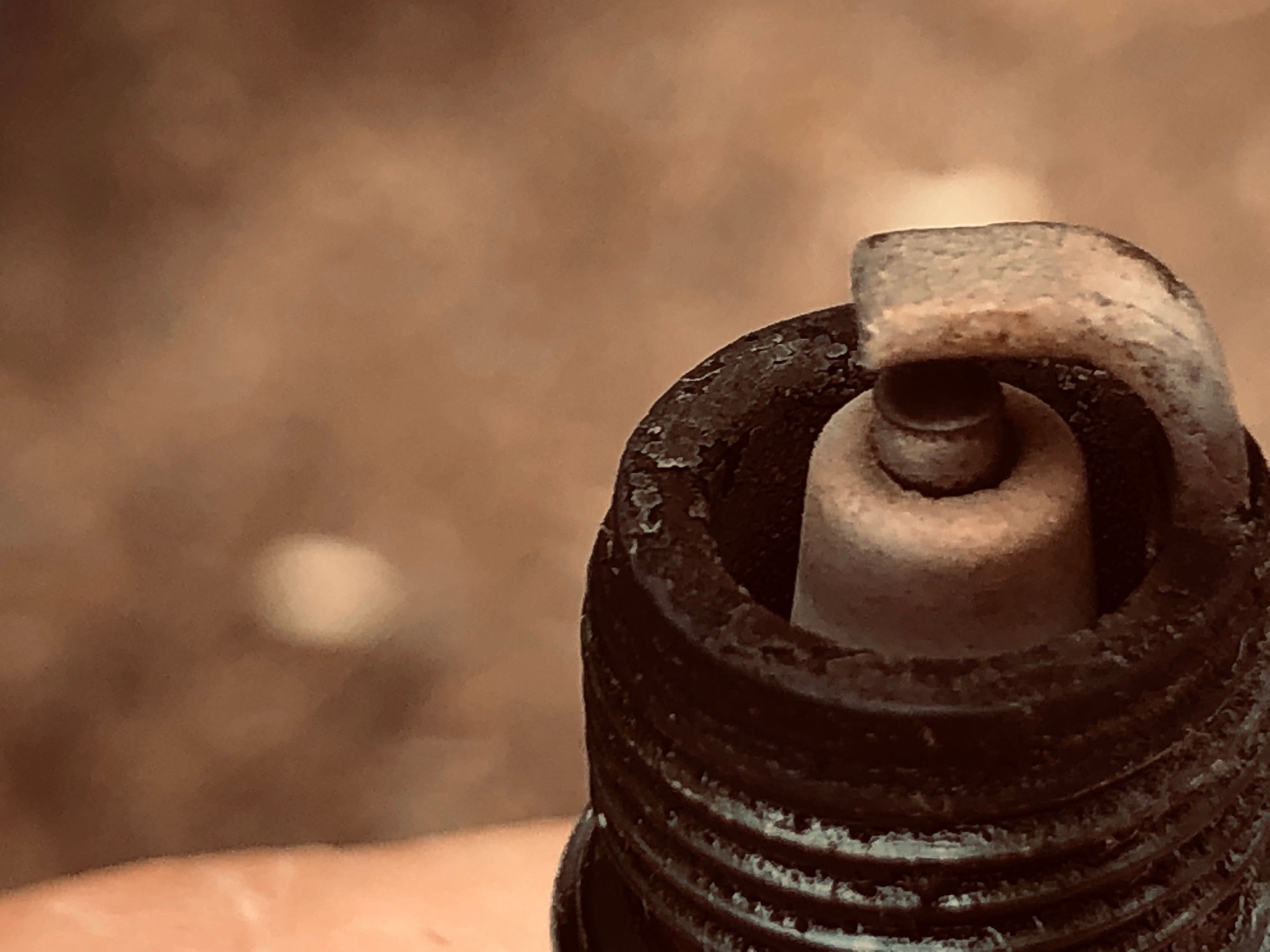

How I am looking here.Close enough?Thoughts

It looks about as good as you could ask. dirty white is the sweet zone.

That plug doesn't look happy. Looks too hot and lots of deposits.

A plug that's clean is too lean, as they used to say.
it looks like a used plug that's jetted right and not burning any oil.

looks ok to me, looks like the burn is concentrated at the center and darkens slightly as it goes away from center.

Is that a stock spark plug with the stock heat range? I can't claim to be a spark plug reader, but this is where to start.
The idea generally is to first optomize the air fuel mixture using stock plugs, a very common error for example is to install a hotter plug to compensate for excessive fouling due to an over rich fuel condition because of a misadjusted carburetor. In this case the correct procedure is to remedy the over rich condition versus installing a hot plug.
Performance engines use a colder heat range, etc. For most of us, stock spark plugs in stock engines are perfect. Just some background thoughts for you, maybe you know this stuff already.

Reading plus on today's fuels is difficult about all can use it for is to tell you if it is running too rich, what traditionally would look to be too lean can be just fine today's fuels, especially ethanol laced ones burn very clean and do not leave anywhere near the combustion deposits of the gasolines of days gone by.. Yours look to be ok. With most of today's fuels, a stoichiometric air-fuel mix tends to leave plugs clean with little to no combustion deposits, a state in years past that would indicate an overly lean fuel-air mix.

It's not rocket science. off white to tan is exactly what you want. the reality is as long as you're anywhere in the good zone there are better things to worry about.

440 is spot on. That plug looks fine. If the other 7 look that good, run it and be happy. It's not quantum physics like some lead you to be believed, especially if you're just stuffing plugs in a stock motor. Even then of you're off a heat index or so, or if the plugs aren't perfectly colored (but still close), as long as they all look alike and have a decent gap you're fine.
