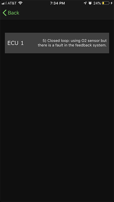

OBD2 says - ECU 1 1) Open loop: insufficient engine temperature.
could this be a thermostat stuck open issue??

Coolant flushing by itself shouldn't cause any starting issues, the open loop DTC as a reason or cause of non-start wouldn't apply during initial start up---the PCM allows for that until the embedded coolant temp sensor reads upwards of 195* or so.

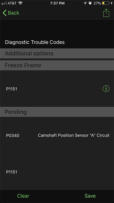

still getting these codes - persistent P1151
and pending P0340..
thinking I will:
check alternator AC current
check the upstream driver side upstream O2.. (not sure how to test it)

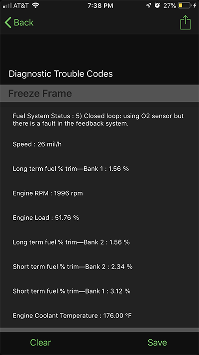

The LT fuel trims look good, surprised those aren't a bit higher if the 02 isn't working as it should. Your coolant temperature is a bit low--should be closer to 190* F.
The clutch fan doesn't "kick on"---it spins the whole time the engine is running. It might be free wheeling during start up and until the engine temperature causes it to engage more fully in order to turn faster to maintain the desired coolant temperature. But once again your coolant temp doesn't seem to reach the design temp so the fan clutch would be quiet for lack of a better word.

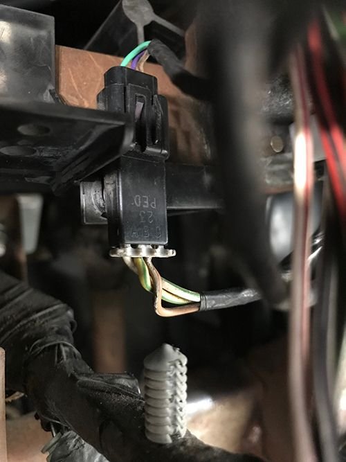

hey guys... wonder if this could be causing my no-start issue.. (cranking fine, no start)
found a broken 3 wire (green/white, purple/orange, Grey/blue)
second pic is where it connects under the steering column to (white, Yellow/green, Brown/white)
idk it started fine a while ago before I found it..
seems like all this started after the Radiator flush!?
still need to check fuel pressure.. guys at auto part store gave me a vacuum gauge. DOH!
also it's difficult to shift it into PARK!! maybe i messed something up when i replaced shifter bushings..
maybe it's the fuel pump, egr, IAC? ah don't know!!
I did replace the cam sensor.. swapped a bunch of relays.. are ALL the big relays under the hood the same??
