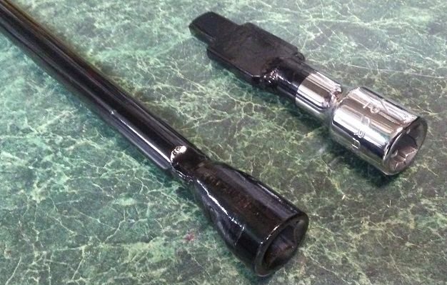

Bought an extra OEM jack via fleebay and made an adapter to run it up using a battery powered 1/2" impact drive (smaller item in photo below). Move about on a creeper under the rear, jack one side up, place jack stand, lower... then repeat on other side. Move to the front and jack up one & then jack up the other. No jackstands at the front, but then again, I am not getting uder the vehicle ... just moving wheels about.
