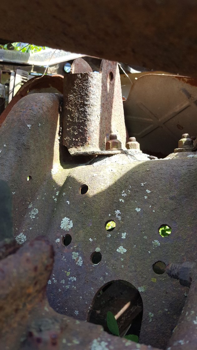

this what they look like?

Originally Posted by Phase3
I thought he was talking about the passenger side. That one looks like the driver side on my 250 2wd.
18795376
I don't know if different engines used different brackets but here is my passenger side. 7.5
