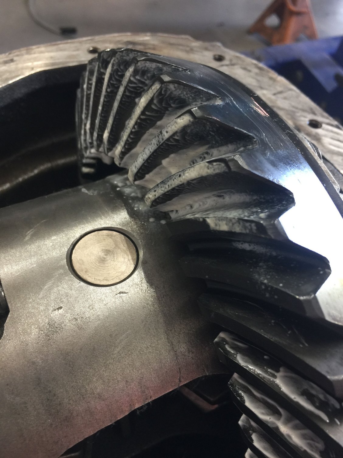

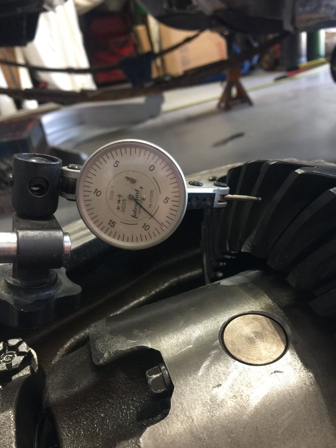

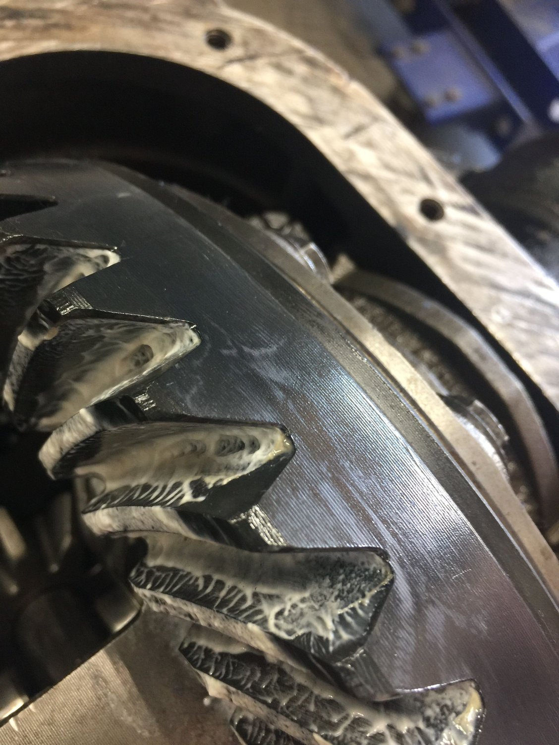

It’s back together and I feel pretty good about it. I think the gears will be ok. Backlash is about dead middle of the listed specs of .007-.009 at .008. Pattern looks pretty good.

It’s back under the truck. Test drive it and there’s a faint hint of the same noise in the mph range of 40-50mph. I suspected this since I drive a 100 miles with a bad set up. Just need to drive and see if it will settle in and establish a normal pattern now that I have the set up correct.

I have had good success reusing gears, as long as I get NEW bearings and a GOOD pattern.
