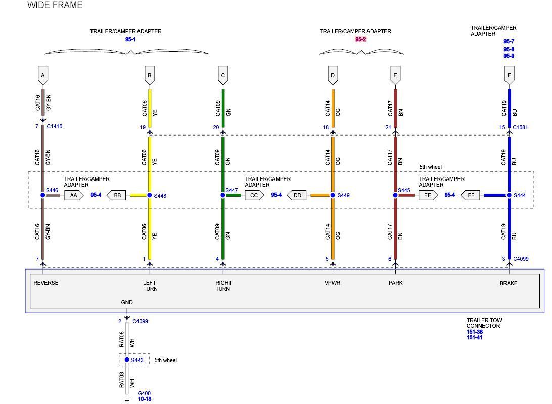

I have a 2011 f250 Lariat. First time I hooked up my rv to the 7 pin connector. Nothing works. The truck won’t even recognize the trailer. No lights or brakes or anything. I have checked some fuses but I don’t have my manual and everything on the interwebs has poor diagrams. Can anyone help me out? I’m sure it’s a stupid fuse, but I can’t find it.

Here are some schematics that might help

Thank you. It’s helpful for sure. Seems all the fuses are good. I don’t know what the deal is. Unless it’s a busted wire or something. Time to get my voltmeter.
