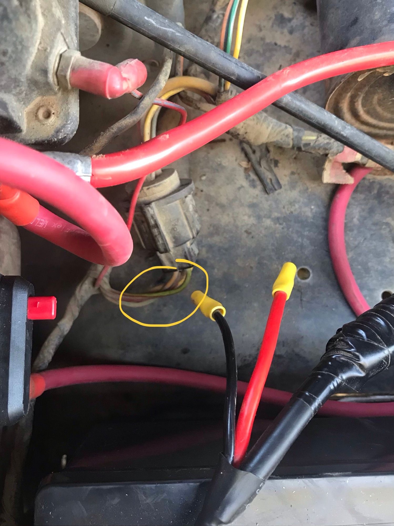

before I cut anything just wanted to verify this is where i connect the g/r wire from the alternator

I haven't done the upgrade myself yet so I don't want to chime in on the wire but in preparation for it and the voltmeter change I pulled a length of the harness that matched mine from a parts truck. I am going to cut that harness in half where needed and then flip it around and splice the wires that need to remain intact. This will create a jumper harness that I will put between the plugs of the factory harness allowing changes to be made to the jumper but not cutting anything on the factory one. Make sense? Just an option if you don't want to cut yours.

Thats a great idea. i've already got mine almost done, just have to put the smog pump back in and should get some new vbelts in the mail today. I was 99% sure that was the correct place to put in the wire from the alternator, was just looking for confirmation.

The correct wire should go to the old regulator. Is that too far away to use?

Just wanted to thank you all for the help. Got it all finished up yesterday at a friends (who happened to have impact wrench lol) and drove it 80 miles home without any issue. I did end up using the washer off the new alternator pulley between the alternator and the original dual vbelt pulley. Just an FYI, I did pull the original white/bk choke wire from the original harness and used a quick splice connector on the new pigtail. Green/red wire went to the location shown in the previous photo (which was right below where the old regulator was located). I also ended up using a bussmann 150 amp circuit breaker and mounted it using one of the same holes as the old regulator. Again, thanks everyone. I wouldnt have even attempted to do it myself without such great support from here!
