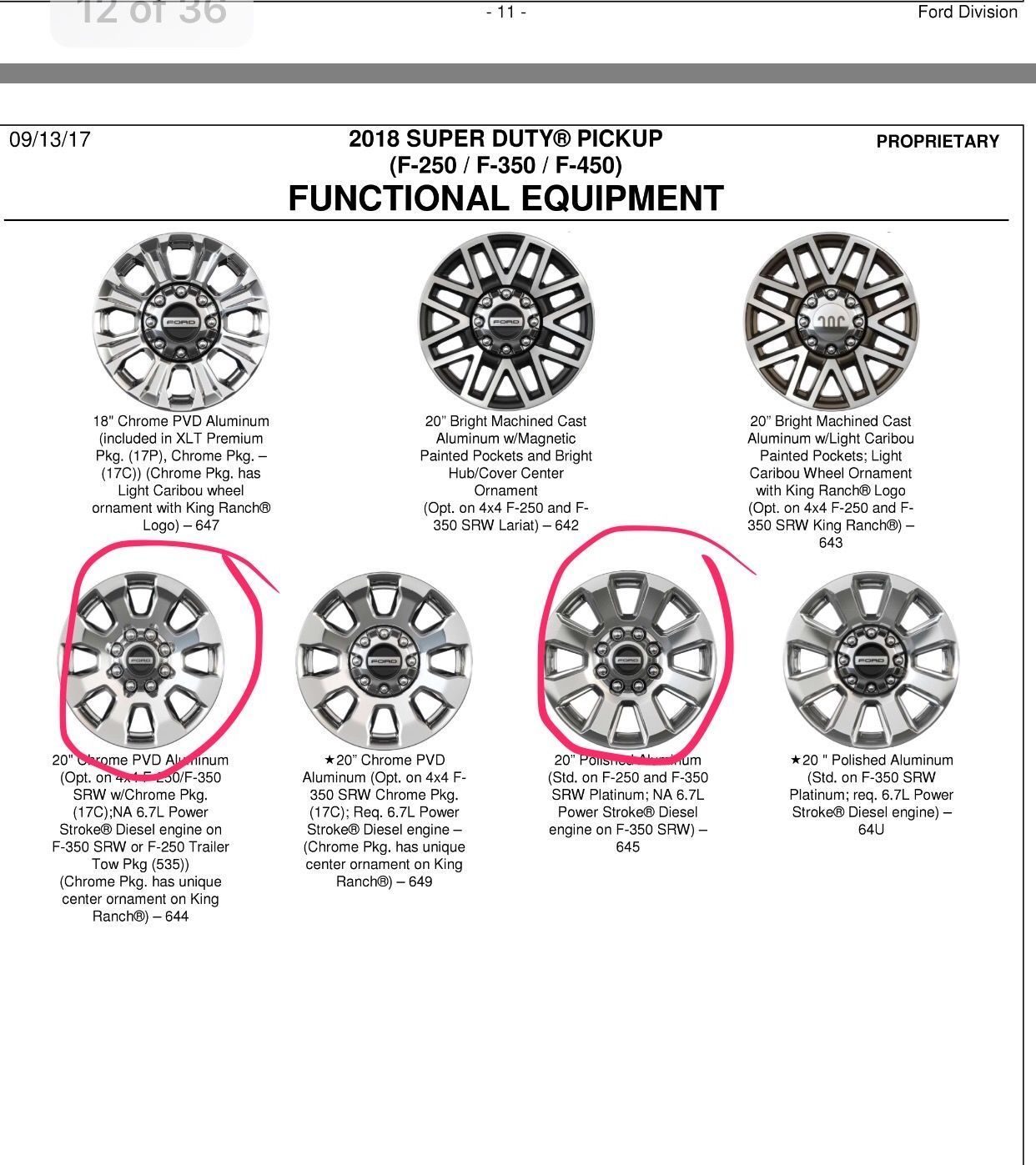

Been looking for a set of winter wheels for my 2018 F250 Platinum. IN searching there has been 2 styles I have found. The style I have on the truck, which are a one piece, and then a bunch of sets that have a center hubcap (see attached). I have found this for basically every trim and wheel style, where there is a version of the wheel both with and without the center hubcap. Any ideas? could it be F350 v F250? Some descriptions specifically mention FX4. Could this be it? OR am I being dumb, and theyre the same wheel and the cap is removable, to where theyre the same wheel under?

Different hub diameters. Those two wheels are not interchangeable.

I was under the impression the trucks with the M275 axle got the center caps and trucks with the 10.5 sterling got the wheels with no caps. I could be wrong but that's what I remember.

You can run the 350 wheels on your 250. Just can’t run your wheels on a 350/ truck equipped with the Dana M275 rear axle.

The circled wheels will only work with 250/Sterling 10.5 rear equipped trucks. Other wheels can go back and forth.
