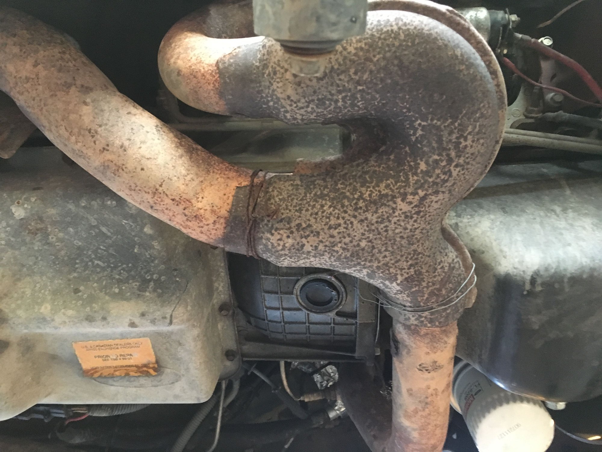

Does anybody have a picture of the Ram's Horn and T-shaped abomination side by side? Mine is a 2000 6.8L v10 RWD but I don't know mine is. Too old to get on the ground to look. Would never get up!
I don't have a picture of the Ram's Horn handy but here is my factory T shaped pipe sitting next to the full flow Y pipe that came with my Banks headers.

What years did the Rams Horn come on the Ex?

I think (and that has proven to be a very dangerous event.....) that the Ram's Horn came on the '00 and maybe early '01 rigs, but not 100% sure. The T shaped piping was done to combat an exhaust flutter that some folks reported from the Ram's Horn design. I haven't ever heard any flutter from one of these engines with any of the various exhaust systems, factory or aftermarket.

I think the Ram's Horn came on the '00 and maybe early '01 rigs, but not 100% sure. The T shaped piping was done to combat an exhaust flutter that some folks reported from the Ram's Horn design. I haven't ever heard any flutter from one of these engines with any of the various exhaust systems, factory or aftermarket.
Definitely on the 2000.
