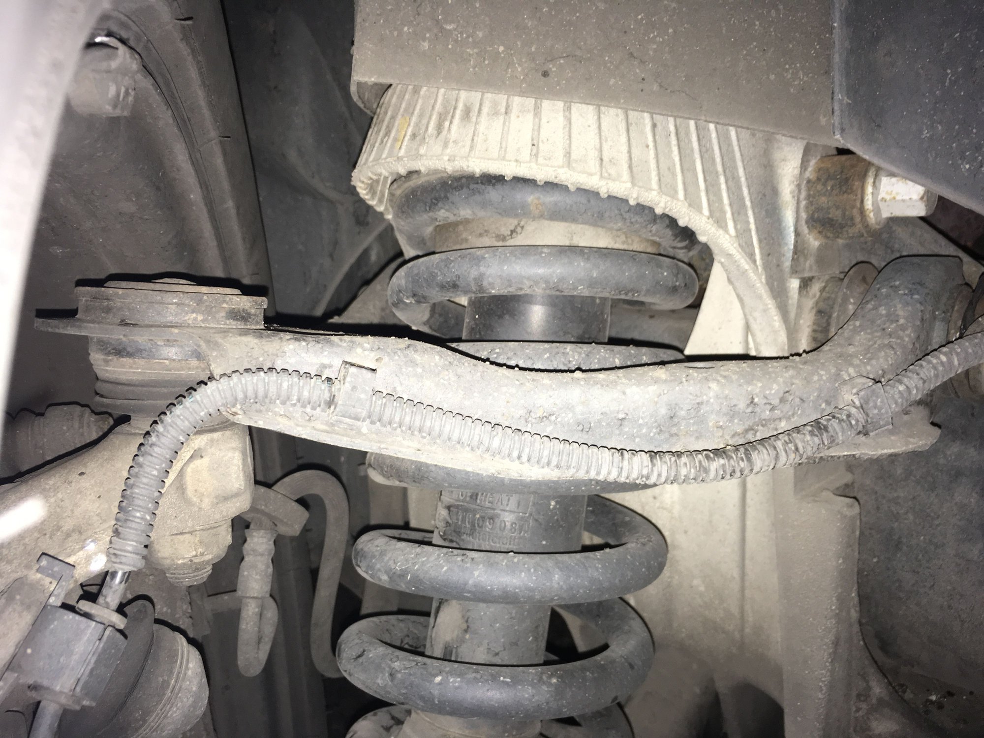

Do I have a stamped steel or forged top A-arm? I believe it's stamped but I'm not entirely sure.

I would say stamped steel from this distance.
