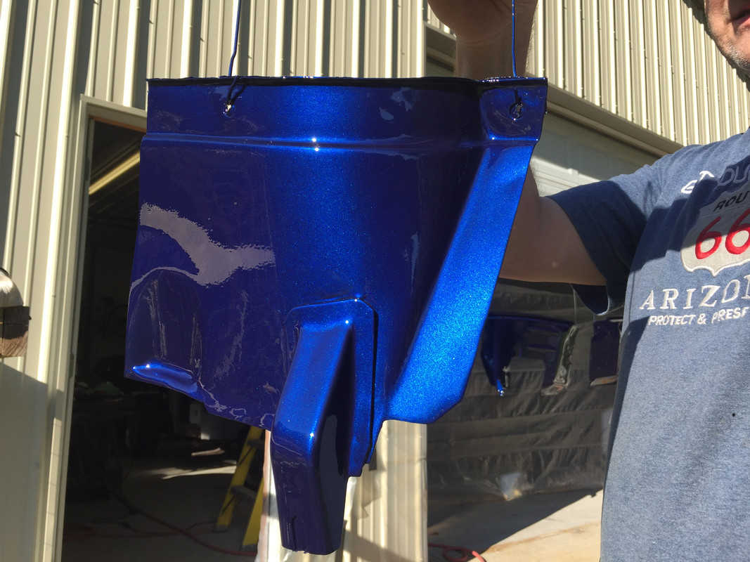

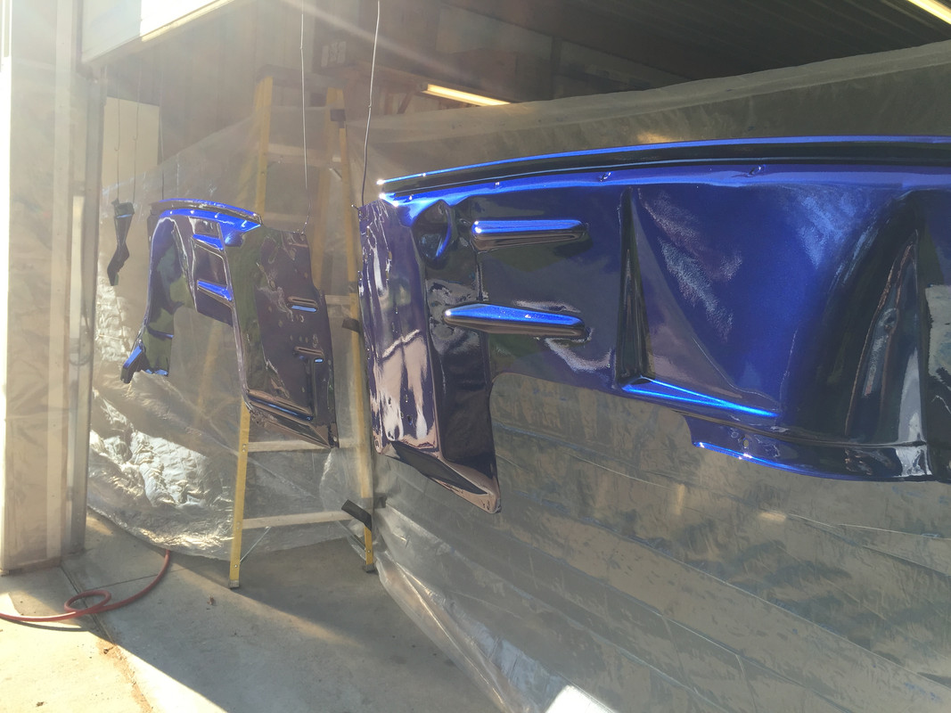

Getting closer to paint time. Wondering from those who have completed the truck painting how many quarts of base coat did you use? I’m going to be using Omni base in Deep Impact Blue metallic and thinking 6 quarts should give me 3 good solid base coats. Full truck, bed, cab, fenders and running boards. Any ideas?

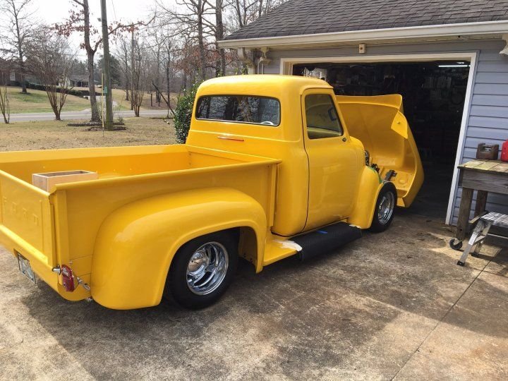

that's a hard question... depends on paint and painter... Mine was a '53 with solid yellow over a white sealer... full tilt front end (in /out) cab, bed, running boards, inner fenders on rear and tailgate... don't know number of coats but it was 3 gallons of color with enough left over to cover the bottom of the third can...barely. Then the clear. there is a LOT of metal under paint on these old trucks ....YMMV

As for John's truck...yellow is the worst for coverage. It will drive you crazy, just when you think that you have sprayed enough coats you will find light areas. If you do that again John try a coat of KD3003 first, you will use a lot less yellow base after it. I love yellow but hated to spray it until I found tinted base.

Thanks for all the comments and advice. A bit of background. As for using Omni paint, I have already done the inner fenders (over black sealer) and I am happy with the quality of cover and finish once the clear coat is on.
