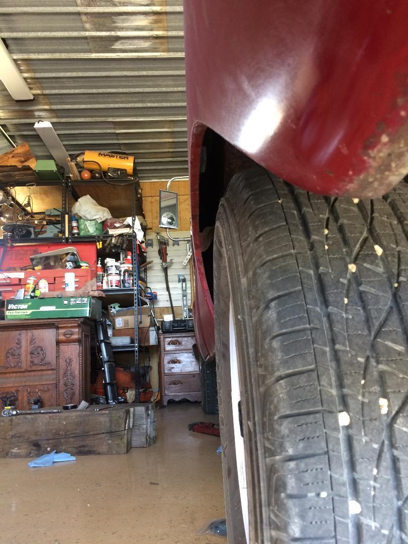

Here are a few pictures I swapped out the 65' 4.10 for a 79' 3.54. Overall the engine sounds better going 55-60 and maybe dropped the rpm's by 200 or so at speed. Time will tell if it makes a bigger difference or not.
I know that this pops up occasionally but I need help determining what speedo gear to go with. Speedometer about 5 mph off at 60 ( shows 55 at 60). Truck has a NP435 and 245 70 16 tires.
Any help would be appreciated. There were no problems with the 4.10 in case anyone is in need of one for a good price.

Your truck is a 1965 F250 w/a swapped Dana 60 3.54-1. What trans does it have?

The only issue with the speedometer is the P-metric radials which were not available back then. Parts catalog only lists the bias ply tire sizes. So you'll have to convert the P-metrics to the bias size.

The trans is definitely the NP435
The tires on it P245 70R/16 measure at 29.5 inches with weight on them.
The previous tires were Dunlop 6.50-16 they are still in my neighbors barn and measure approximately 29.75 without any weight on them.
I would say with weight they would be very close in size to the current tires.

NP435 & 3.54-1
6.50-16 tires only listed for F100.
2WD: C3DZ-17271-B .. 17T Nylon DRIVEN Gear & C3OZ-17285-C .. 7T Steel DRIVE Gear
F250 2WD with 7.50-16 tires: C0DZ-17271-A .. 16T Nylon DRIVEN Gear & C3OZ-17285-C .. 7T Steel DRIVE Gear
The DRIVEN gears are available, but the DRIVE gear is obsolete.

I pulled the driven gear and it's a 16 tooth. I take it I'll just have to replace the other if I can locate it.
Any idea the skill level involved with that.

A 265 70R/16 should solve the problem.

Would anybody have the exploded view of the NP435 that may show the drive gear

17285 near rear of case.
