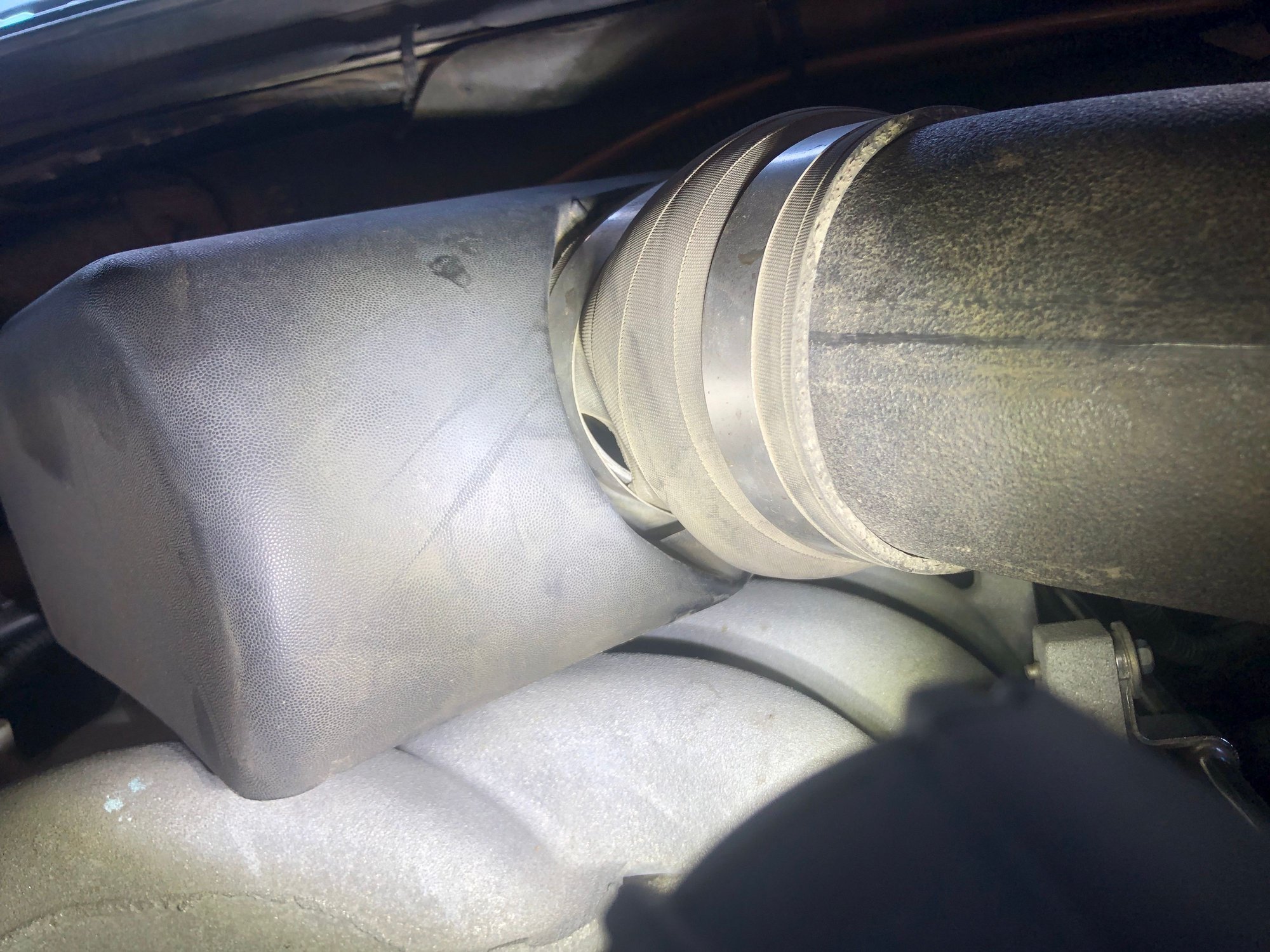

Here's a picture of the Man Made trouble:
Can you see it? That little hole is between the intake boot and the throttle body. In my haste(again) to get going I did a lousy job of re clamping the boot. This showed up a "lean switch" problem on the 02sensors BK1 and Bnk2. My wife had enough and fired me.
