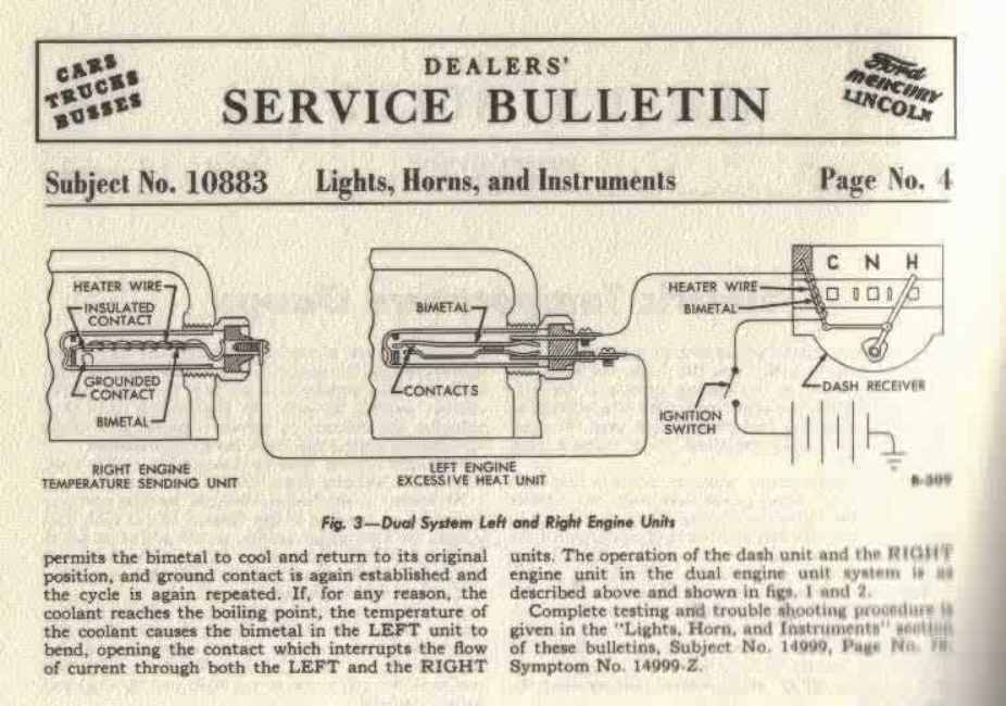

Great information guys thanks so much. One more question, the temp sending units have a wire from one to another then to the gauge, would the temp gauge be giving you the hotter of the two or is it a combined reading to give you an average?

The temperature gauge system measures the temperature in one of the heads, the side with the single-terminal sending unit. Power is fed to that sender thru a switch ("excessive heat unit") in the other head, that opens when boiling temperature is reached. As you may have noticed, with no power to the gauge, the needle points to Hot. Similarly when the power to the sender is interrupted by the temperature switch, it sends the gauge to Hot. So it only measures one head, but "monitors" both.

Great information! Thanks so much for the diagram and taking the time to explain.
