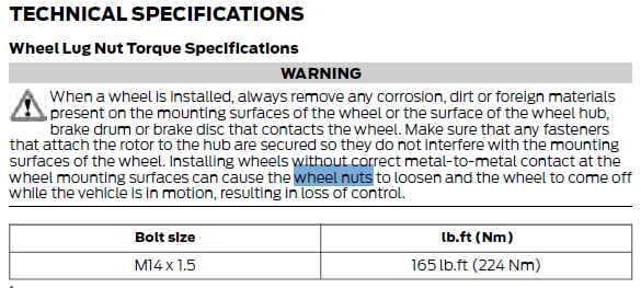

Ford likes to keep us confused. 2017 lug nut torque is different. This is the from 2017 Owner's Manual.
Something not many people know is that our lug nuts on the Super Duty are two piece. There's a washer on the lug nut and the Owner's Manual calls for a drop of oil between the washer and the head of the lug nut. As near as I can tell, the washer has indentations in it that keep the lug nut from coming loose when properly torqued. If the lug nut is too loose then the washer doesn't come into contact with the wheel and can't keep the lug nut from loosening. I do the drop of oil every other tire rotation.

Originally Posted by seventyseven250
Oil the threads and go to 150, close enough (sorta)
You oil between the nut and washer, 1 drop. Not the threads.
Yeah, I know that's the right way to do it. I was making a joke about how to use you 150 ft-lb torque wrench and still get to "sorta" 165 ft-lbs. It's the wrong way, don't follow my suggestion, it was not serious.

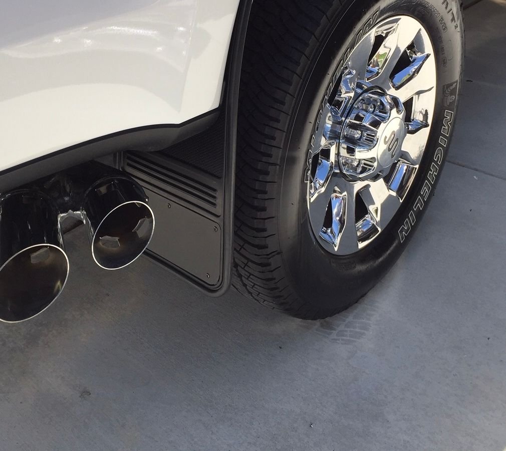

I don't pull the hub cap first. I just loosen the lug nuts, and it will lift the hub cap off as you back them out.

On my 2021 the lug nuts are under the hub cap.
Mine too. SARDiverDan's truck is almost exactly like mine, so I don't understand how that works.

Mine are not covered.

Oh, I didn't realize the KR caps didn't cover up the lug nuts like the Lariat trim level caps do.

I think the KR, Platinum, and Limited all have exposed lug nuts around that time. Not sure if they still do.
