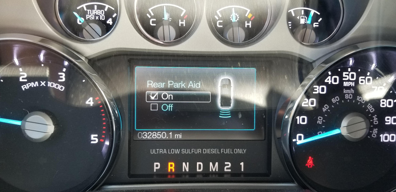

Do you have the modules settings to make these changes? I do not believe it is as easy you want it to seem.
I am not aware of any settings that have been identified in the IPC or other modules to turn off PAM perm or temporary.

Do the 19's not have a pop-up in the message center like the 16's do?
When in reverse without a trailer connected I get this pop-up in the message center. Arrow Down and Press OK.....Alarm is temporarily silenced. If Ford took that feature away that is unfortunate.

Nope. Still in the 17+ trucks. Backing up to my trailor I simply go to off

I don't get the pop up, I have to scroll over to setting and then scroll down to rear park aid and select off
