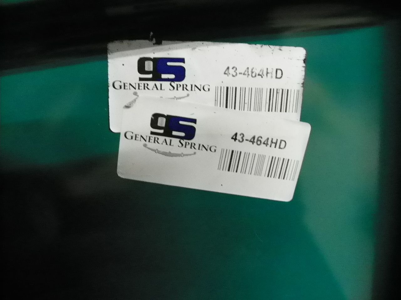

I bought a unfinished project truck that had a bunch of new parts. These springs were part of the package so I don't know much about them, yet.
