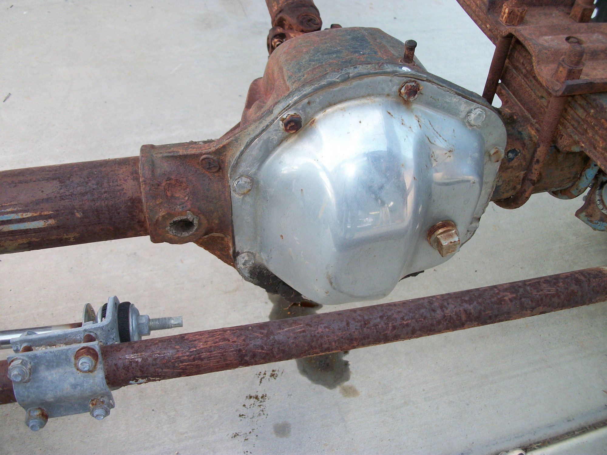

Does that front axle have open or closed knuckles?
Old Aug 4, 2019 | 05:51 PM
53deere's Avatar
53deere
Joined: Nov 2005
Posts: 1,852
Likes: 437
From: Lehigh Valley, Penna.
All F100 4x4 leaf spring front axles from 59 to 65 were closed knuckle. All 1/2 ton 4x4s 66 to 79 had coil springs. So unless it was modified or pieced together it should be closed knuckle with drum brackes.
Old Aug 4, 2019 | 10:27 PM
hotfalcoon's Avatar
hotfalcoon
Joined: Jul 2010
Posts: 330
Likes: 15
From: Reno,NV
You are almost right, I am asking because the transfer case is not period correct and the cross member modified, so it’s possible the front axle could be modified from it’s stock configuration.

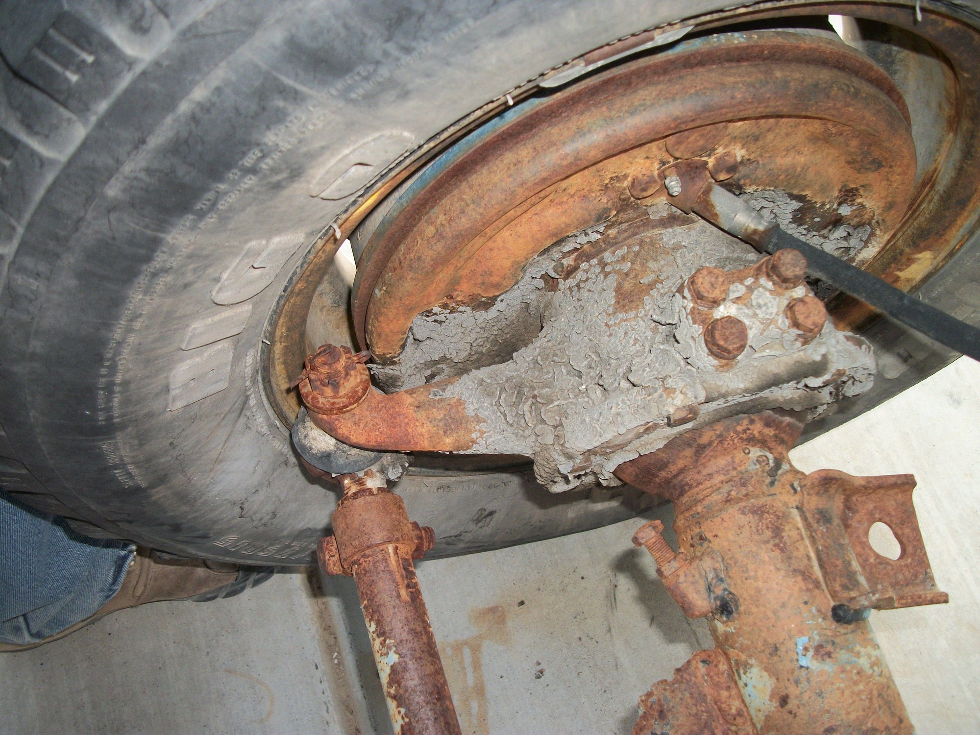

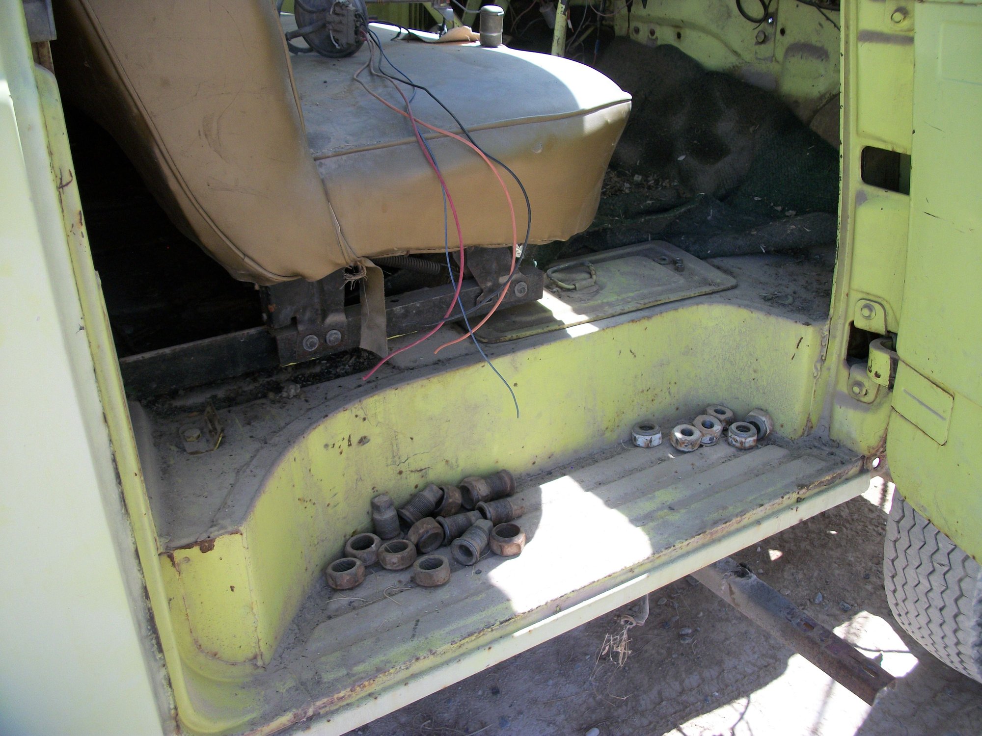

Here are the pics of the shifter arms that I went to Vegas to get/ Do these look right? Here is the closed knuckle.
not sure if these are correct
Old Aug 6, 2019 | 11:08 AM
Byrd.Dog's Avatar
Byrd.Dog
Joined: Aug 2010
Posts: 1,049
Likes: 230
From: Amarillo, TX
The shifter/linkage on the bottom is the correct one for 59-60 4x4's. The axle looks correct also, as I believe the kingpin bolt pattern for later closed knuckle 44's was a trapezoid shape, vs. rectangular for the 59-60.

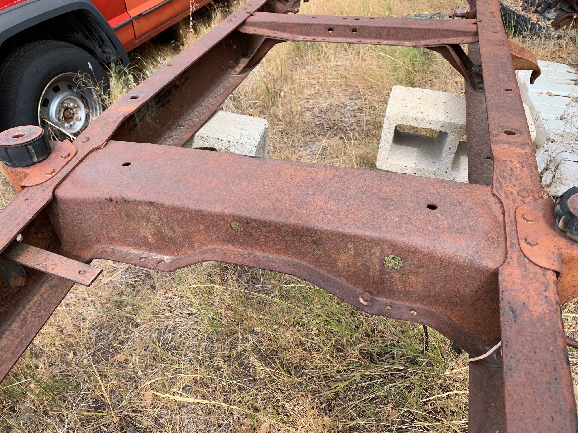

Here is a couple pics of the transfer case cross member on the ‘75 frame
Old Aug 6, 2019 | 10:48 PM
thrifty's Avatar
thrifty
Joined: Oct 2009
Posts: 708
Likes: 28
From: Pahrump, Nv.
hotfalcoon that crossmember does look the same, like you said. Thanks for the pic.I have another cab coming, so when I pull this one off I will be able to see the mess with the metal work on the crossmember and determine what needs to be done. Byrd.dog thanks

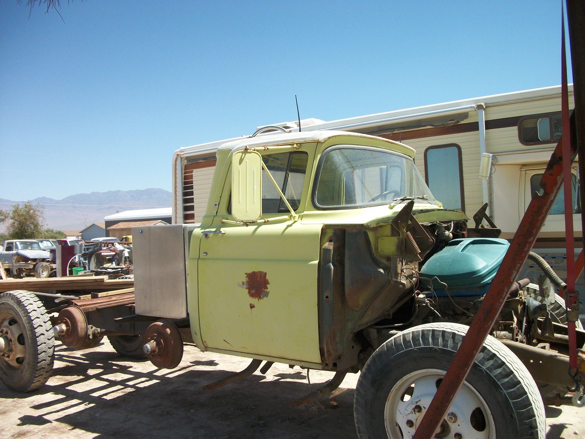

Here is the replacement cab for this project. My buddy still has to pull it and deliver it to me. It has a few issues but they are repairable.
Next in line at the gantry
Nice steps
it needs some repair but not bad
Old Aug 25, 2019 | 07:28 AM
53deere's Avatar
53deere
Joined: Nov 2005
Posts: 1,852
Likes: 437
Looks to be a really nice unmolested cab.
