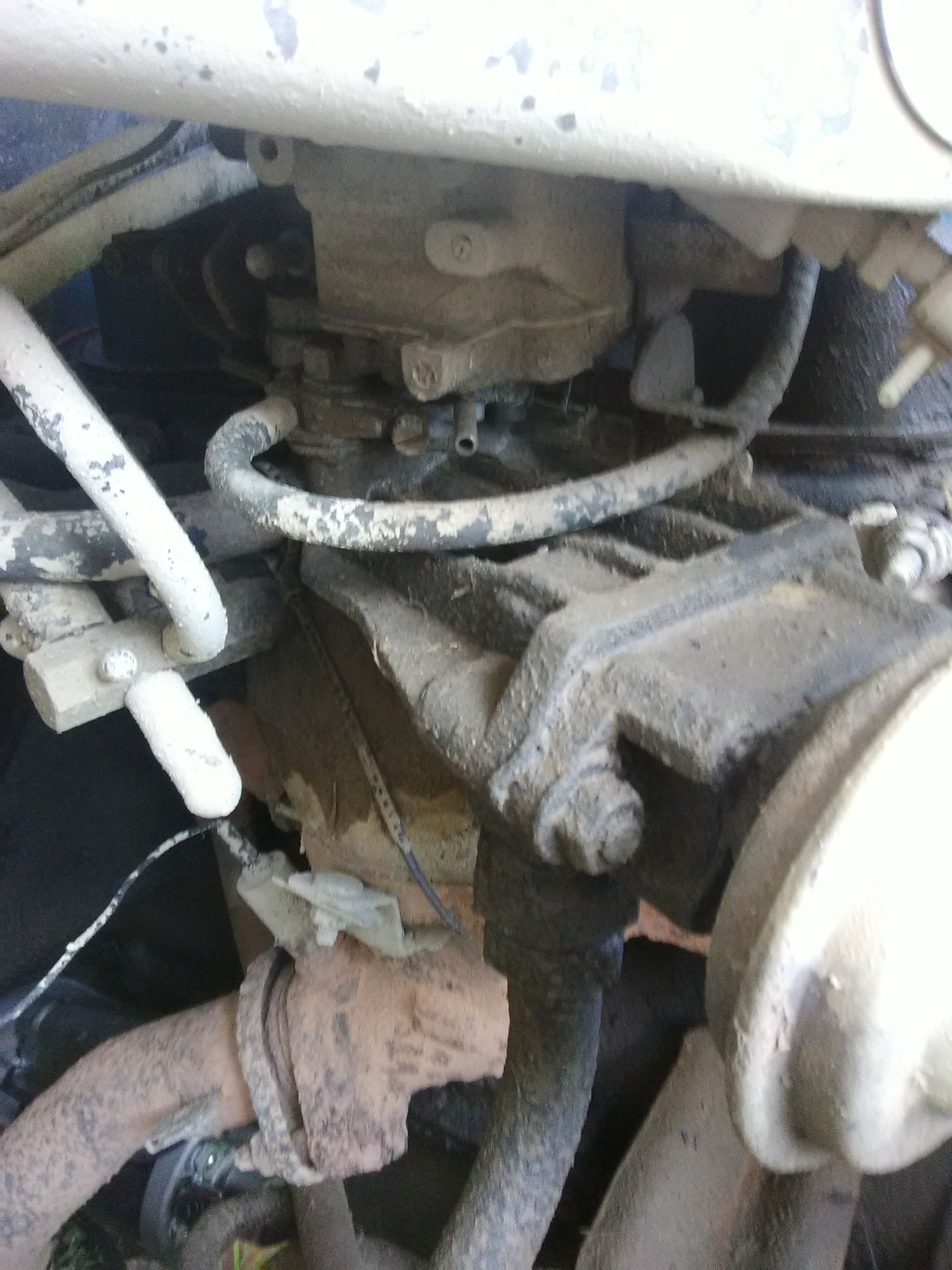

ok thanks & was wanting to see if anybody might know why it will not start. It was running fine on way home an think blew head gasket lost all oil & antifreeze. The oil was coming from the push rod cover gasket & the antifreeze was coming from the coolant reservoir. After I got it towed home hit the key an nothing no sound nothing. I replaced the starter solenoid & starter an still nothing. The guy I got it off of said it was going through starter solenoids & the wiring that was there had cab lights wired to cb wired to dome light wires. Then there were 3 wires running from cab lights to 3 fuses in fuse box. I unhooked them hoping that would solve problem an still nothing. When I turn on the headlights nothing happens. I have pics of all the lose wires to see if someone can figure out what the problem is.

Old Aug 18, 2019 | 06:54 AM
Franklin2's Avatar
Franklin2
Joined: Jan 2001
Posts: 56,997
Likes: 2,744
From: Virginia
The picture below doesn't look correct. You should have a smaller wire under the large terminal that goes to the battery +. Where does that thick red wire under the small screw on the right side go?

DaveF is right on the wires.
If me I would hit that engine bay with a power washer to get the mud off so you can see what you are doing.
I don't think you should have that many 30 amp fuses in the box. I would check the cover and see what should be installed and install the right sizes before you burn up what is left of the wiring.
I would also find out what that mess is just inside the door under the dash and that wire going up the door post?
If the wire nuts are on the right wires I would ditch them and use better connectors.
You have your work cut out good luck
Dave ----
BTW the open port on the carb can be plugged for now as it is a vacuum leak right now.
Also that wire coming off that thing (O2 sensor) on the EXH. pipe would get plugged into the harness to give feed back to the computer on how to adjust the carb.
I would not worry about it, what year is the truck?
That yellow wire near the brake booster is not used unless you have trailer lights or is it roof lights? but all trucks have it and is left open.
