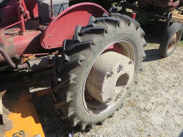

Originally Posted by tjc transport
what size are those weights Larry?
they look like 2.5 ounce each.
Just a Google picture I found.

figured that and was busting your chops.
wasn't sure if that was one of the tires for the "B" or not
Old Jul 24, 2019 | 01:47 PM
Freightrain's Avatar
Freightrain
Joined: Jan 2003
Posts: 9,893
Likes: 12
From: Ohio
LOL!!! Ya, kinda figured.
B model wheel weights getting repurposed................
