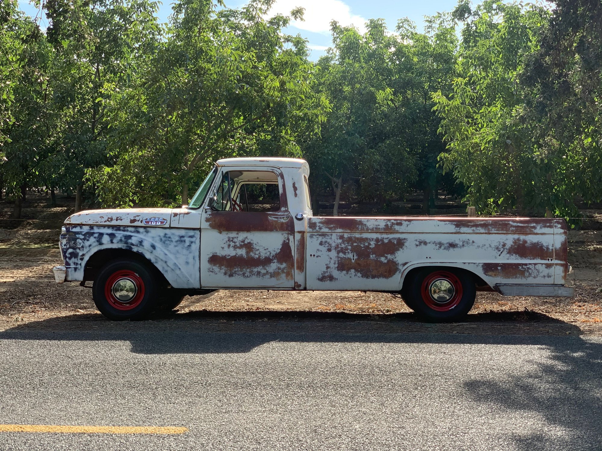

Right now I have this 1963 Ford f100 with a 262 inline six engine backed with a four speed granny gear. I want to do a 302 v8 and t-5 overdrive trans swap. I was wondering what some of the challenges would be in order for me to do this, and just how I would do the whole swap period. I know arc light fab sells bolt in motor and trans mounts.

Love the real, not manufactured , patina of your truck .I hope someone chimes in with the info you need.

Nice paint job. Keep the 6 and built it too your needs.
