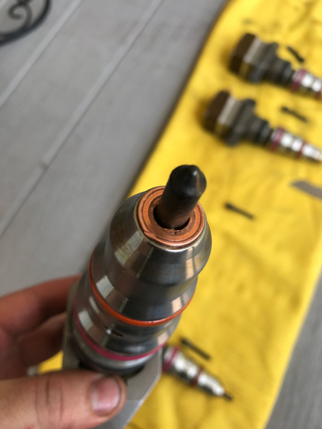

Thanks Nate, we just pulled the DS and nothing really off except the copper washer has a little Knick in it. Injectors were fine before new orings. Think it would go bad just like that?

Well we pulled the DS bank of injectors out and reinstalled/reinspected them. Nothing alarming and we are back to it running again albeit with a little smoke. It’s got a blueish tiny to it.
Put a fresh washer on that. They seal when torqued.
