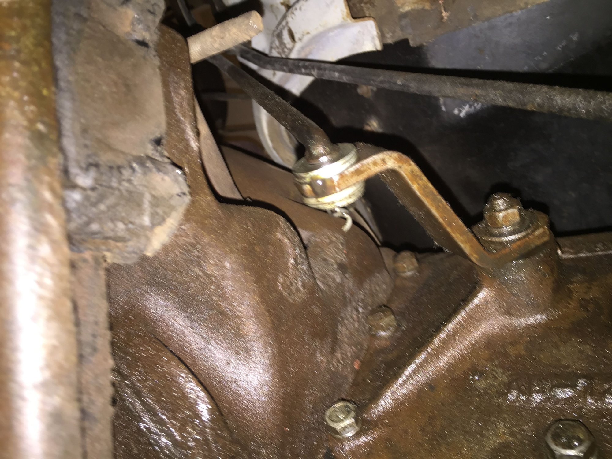

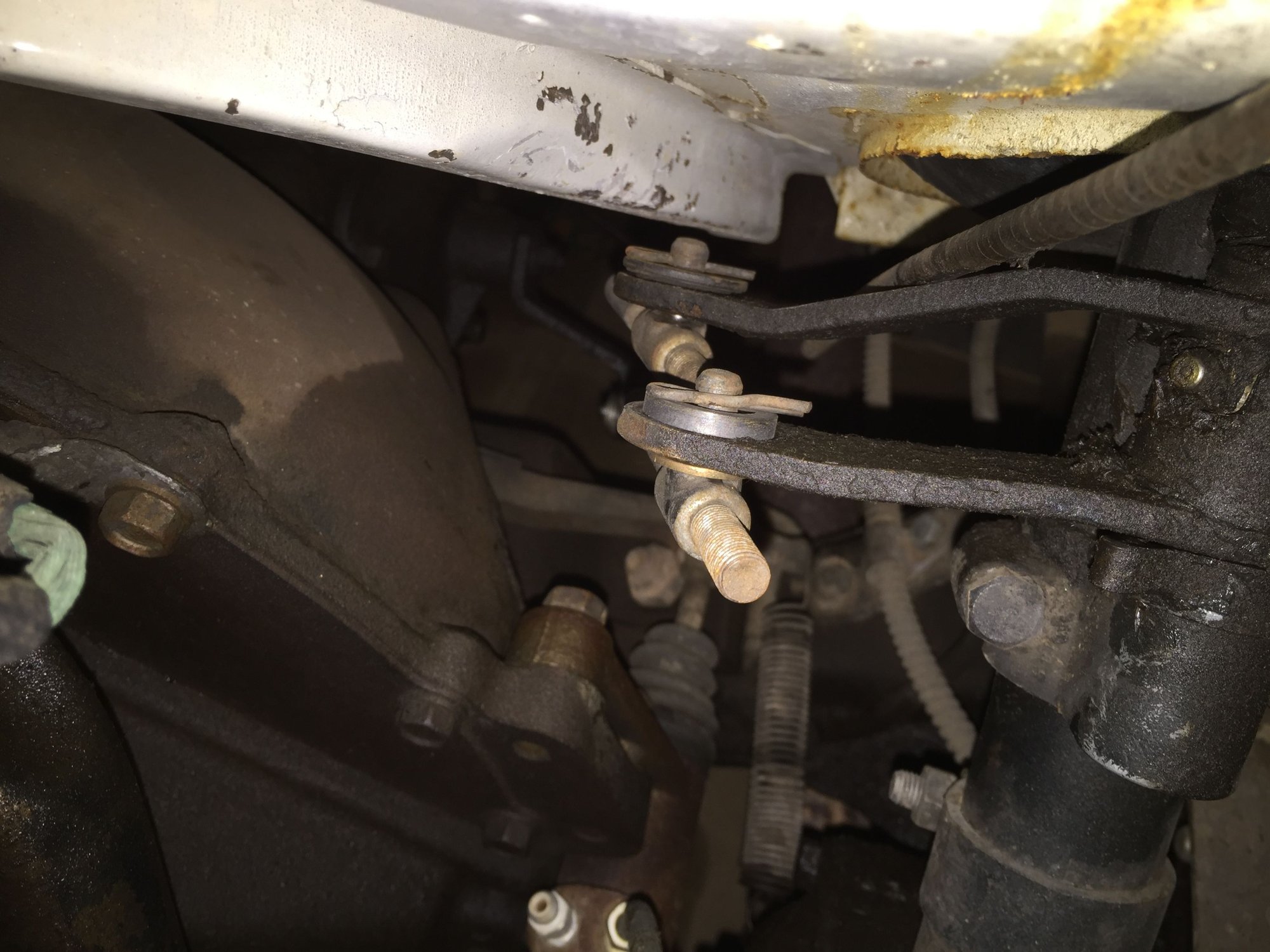

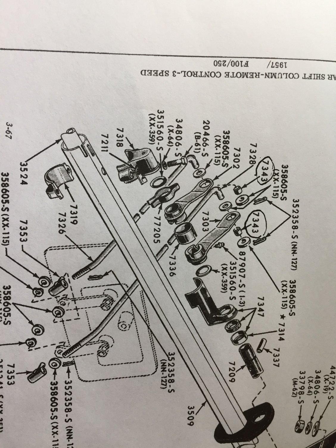

Hi,
Question for the forum: I have a 1960 F-100 I6 with a 3 speed on the column. Upon troubleshooting why the truck sometimes does not go into second gear from 1st, I found there is a lot of play in the upper and lower bushings on the remote control rods. I know the bushing are C3TZ-7343-A and are sold by Dennis Carpenter. My question is, does anyone know of a kit that includes the bushings, washers, and pins that make up the whole setup? I am using as reference page 456 from the 1957-63 Ford Truck Parts and Accessories catalog. I also have pictures of the upper and lower bushings.
Thanks in advance for any advice on there being a "kit" vice trying to get all the parts individually.
Doug

Originally Posted by Doug O
Question for the forum: I have a 1960 F-100 I6 with a 3 speed on the column. Upon troubleshooting why the truck sometimes does not go into second gear from 1st.
I know the bushing are C3TZ-7343-A (These are for 1961/64 F100/250 2WD!).
B7AZ-7343-A .. Gear Shift Selector Arm Bushing & Insulator Kit / Obsolete
1957/60 F100/350 // 1961/64 F100/250 4WD & F350 // 1957/58 Ford Passenger Cars.
NOS PARTS SOURCE in Olathe KS has 1 = 913-220-5746.
KLIMESH MOTOR SALES in Calmar IA has 1 = 563-562-3241.
MCDONALD OBSOLETE PARTS in Rockport IN has 1 = 812-359-4965.
NOS PARTS LTD in Waxahachie TX has 2 = 972-937-2201.
MILLER OBSOLETE PARTS in Vestal NY has 3 = 607-722-5371.
OBSOLETE RELIABLE PARTS in Nashville GA has 7 = 229-686-5101.
No one sells all the related parts in a kit. Just like FoMoCo, excepting this kit, all the parts were sold individually.

Am I crazy or are those linkage arms upside down? Mine has the threaded ends toward the transmission side.
I think you are right. Mine are on upside down. When I look at the schematic in the catalog, it does show the threaded sides at the transmission. I will see if switching them helps my issue of jumping out of second gear! I found that shifting from 1st to 3rd and then into second works like a charm.
Doug
