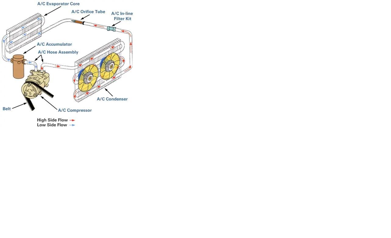

but still out systems are Orifice Tube Accumulator see my diagram above, .. when compressor spits crap it is normally out the high side in the direction of Flow, while I have seen en spit out both sides.
systems that have expansion Valve Drier will catch the crud in the Drier more so than our Accumulator.... see posted diagram note the different placement of the Items.
