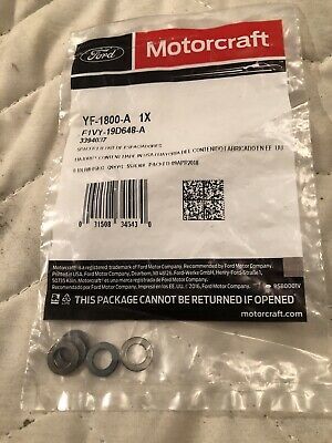

The first thing to check if it works at first and later diminishes is the clutch air gap. From the constant apply and release the clutch friction material wears and it’s not unusual to have excessive gap and poor holding ability after 150,000 miles.
Adjusting the gap is done easily with a change in shims (little washers), once the actual gap is known.
https://www.amazon.com/Motorcraft-YF.../dp/B000C5HYDY
Thanks so much we will be checking this out for sure .
