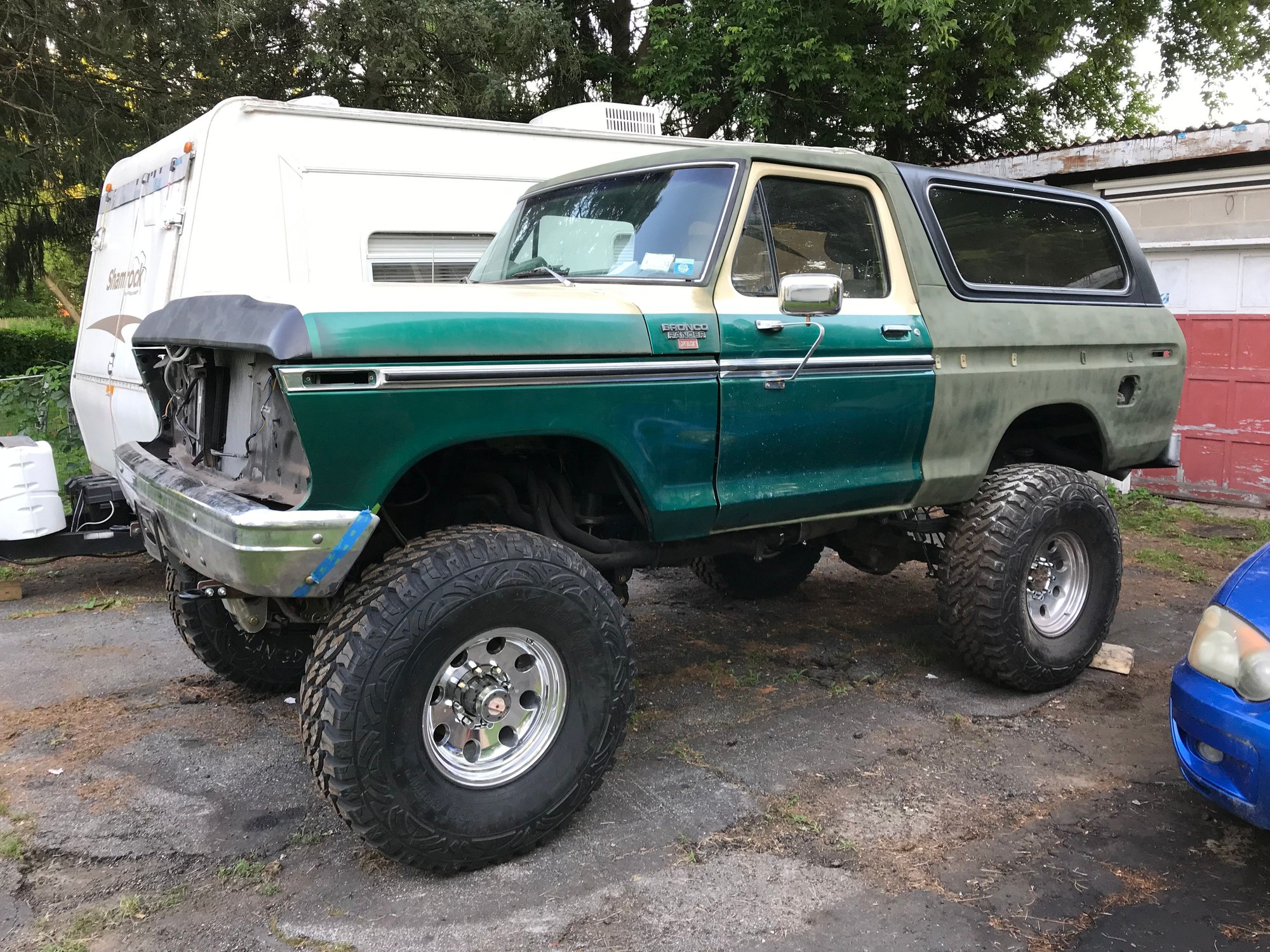

Figured I'd add a picture, everyone like pictures.
Jess
