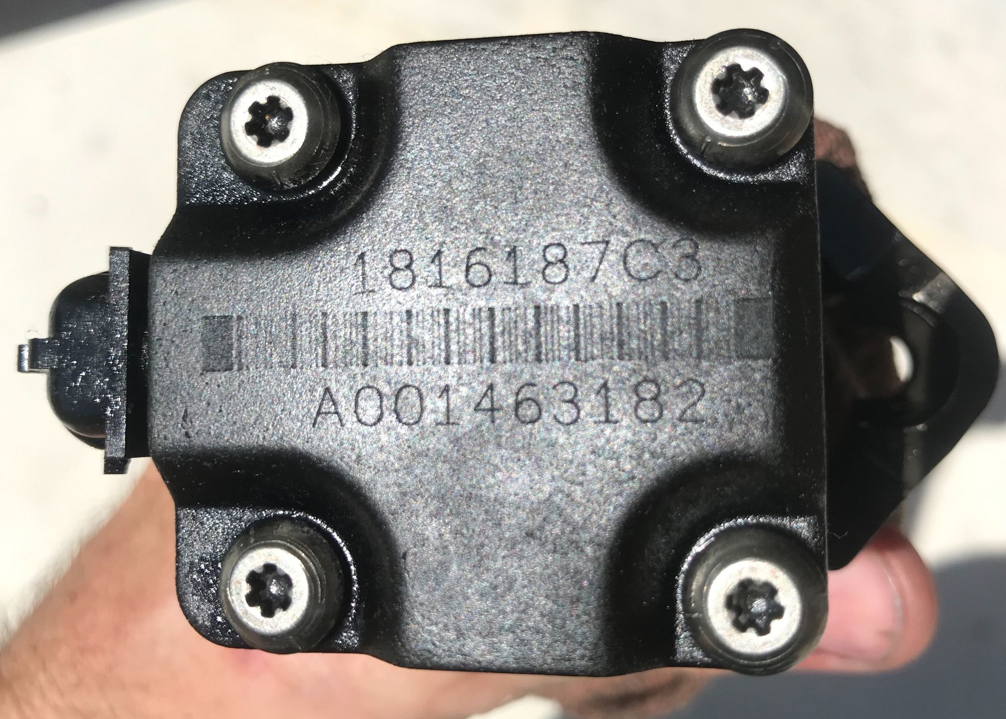

Once I got the injectors out, the o-rings I got don’t seem to match. My questions are:
Are these OEM injectors?
All 8 have the same 181617C3 number. 7 out of 8 have near sequential numbers for the lower number.
7 out of 8 have the same numbers on the side. 1 has UU for the first two letters on the second line.
The replacement o-rings are from NAPA (part # 735-6891) and seem to be significantly different than the originals.
Can anyone tell me if these are the correct o-rings for my application and if so, what is the proper sequencing. My primary concern is with the 3 sandwiched in the groove closest to the solenoid.

you have old style installed
looks like motocraft parts (hope it is)
tip copper washer
small groove orange
middle pink
black ones and support ring on last groove

Some times NAPA sells name brand items under their brand. If that's the case, the packaging should say something like "made by Alliant for NAPA". If not, I'd return them and get these... https://www.riffraffdiesel.com/allia...ector-o-rings/
