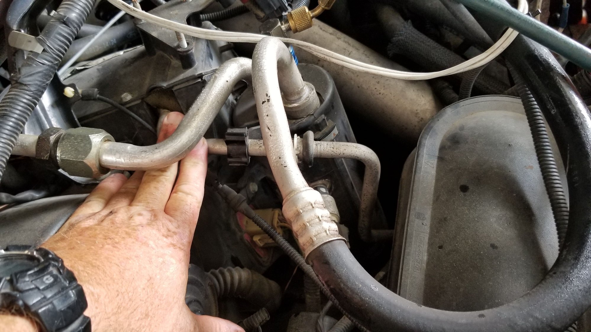

this is some of my issues as well..
How can you tell if the high side filter thing in the line is dirty?? when i have the system running for a bit and feel the line before and after the area where the filter is located I can feel it a bit colder on the line on the "left" side of the filter vs the right side.
if the filter is a bit clogged how do you get the big round fitting with the filter apart.??
in the picture where my hand is the line feel colder than the side to right of the large round fitting.

What you are referring to is the orifice tube. That is the device that meters the refrigerant and allows it to turn into a gaseous state inside the evaporator. Our trucks normally come equipped with fixed orifice tubes but variable ones are available. How to tell if it is clogged or not is if hi-side pressure is abnormally high while lo-side pressure is abnormally low. The left side feeling slightly colder than the right is normal.
That line comes apart similar to a fuel line quick disconnect. You will need to relieve system pressure first.

When i was checking pressure with gauges the high side was 200 and low was 45.. temp was around 80 D.
so I guess the colder feel is the refrigerant being meterred to the evap coil.

With 45psi on the lo-side and only 200psi on the hi-side, I think your compressor is failing. This assumes the clutch is staying engaged.
EDIT: I just realized there are 2 guys on this thread with slightly different issues. The comment above is directed at carl2591
