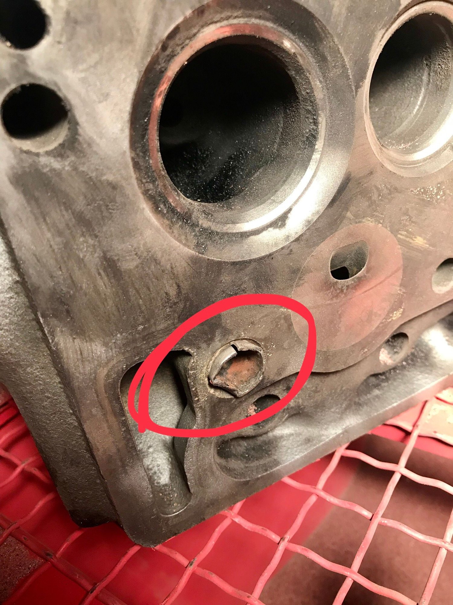

Hi everyone,
I'm new to the forum. I inherited my Grandpa's old F250 with a 6.9 idi awhile back and drove it for several years when the motor gave up on me and blew some rods. I have since found a replacement and decided I wanted to strip everything down and completely rebuild it. I have the block stripped down and cleaned and now I have been working on the heads. There seems to be some hollow alignment dowels (maybe?) in there and I haven't had much luck getting them out. Has anybody removed these before or even know what they are called? I haven't been able to find any info on removing them. Also, any rebuild advice would be greatly appreciated. I am trying to decide how much I want to have it machined (if at all). I don't want to spend a lot of money but I'd also like it to last a long time. TIA

Some have recommended using a bolt slightly bigger to twist them out, not sure on the 6.9 with the smaller bolts, but on a 7.3 you can use the bellhousing bolts iirc. Otherwise, yank em out with some pliars if need be and a machine shop should have some replacements.

Thanks, I've tried using some vice grips but they seem to be pretty tight. I'll see if I can heat up the block with a torch a little and try a bolt.

penetrating oil will be your friend with those alignment dowels.
i can see oxidation between the dowels and head. they will never come out unless you break them free first.

That's a weird one! I've done lots of valve jobs on about every diesel truck head over the years and it just sunk into my half asleep brain. Those dowels are stuck in the head which I've never seen before. They always stay in the engine block as the head is removed and are usually like new and never corroded like in your pic. Looks like the head sat out in the weather for a number of years.

The bolt trick worked. Thank you. I've seen conflicting things regarding machining these heads. The service manual says if the heads are out of spec then they should be replaced but I have seen that it has been done with the precups removed and also not removed. Any advice on reconditioning these heads? I've read through a lot of Racinndrummin's build posts but I can't decide what I should do as far as machining goes. The flatness of the block and heads are within spec but there is some slight pitting. I just don't want to go through all this work and have the head gaskets blow.

IF the Heads and Block are in Spec. then there is no reason to machine them.
the Pre Cups are very hard compared to the Cast of the heads, most machine shops in my area machine them on a surface grinder with the Pre Cups in place.
IF you machine the heads with the pre cups removed then you need to also need to machine the recess so the precup will fit flush.
I would suggest new head bolts.
EDIT: looking at the pics of the Head I can't really tell much (Old Eyes) ... I bet a pass or 2 on the surface grinder would clean em up real nice
