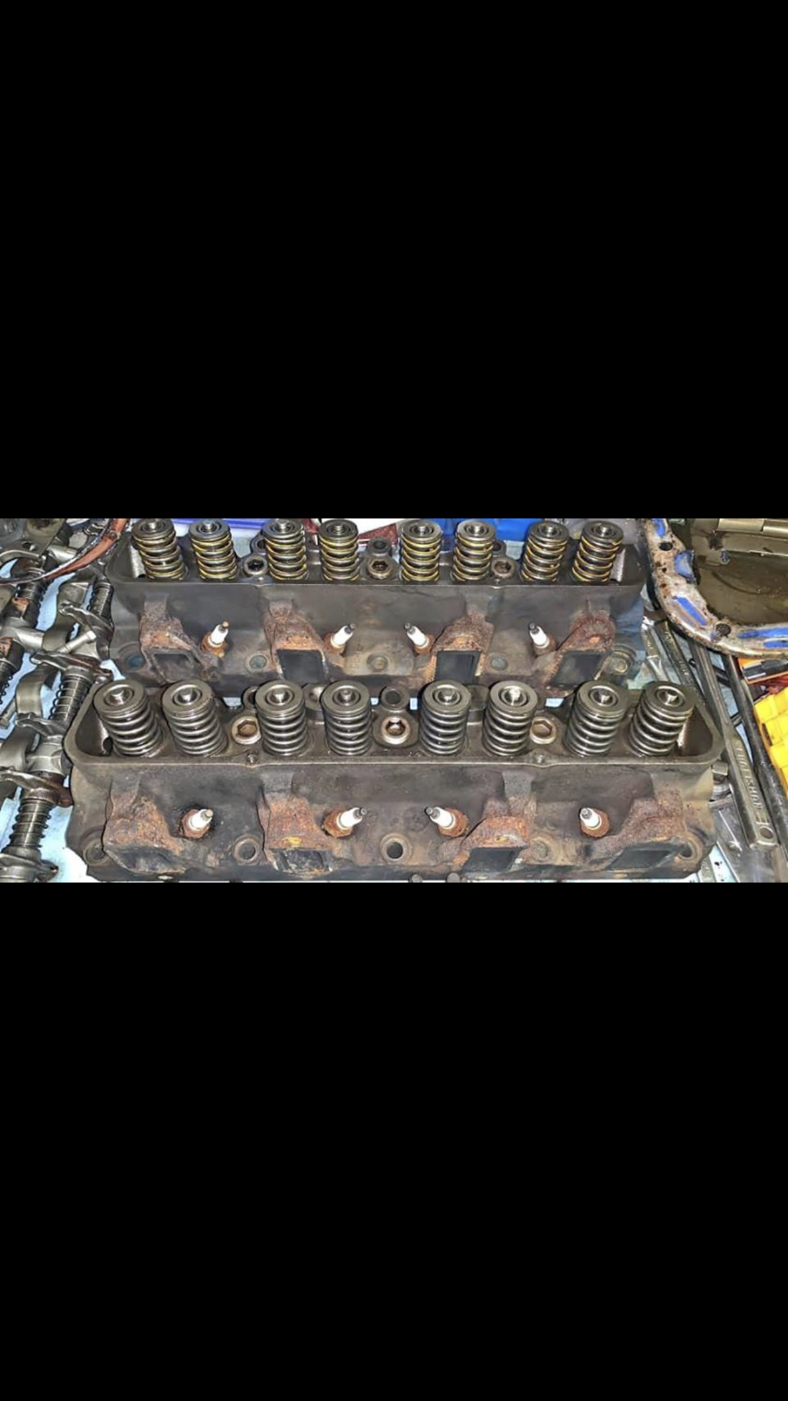

I’m looking at heads from a 74 390. They don’t come with the exhaust manifolds. Can I used the ones off my 352 or get headers? I would have to have the heads rebuilt as well. Guy also has the block that is torn down . Would I noticed a big difference from my 352 and is a 74 engine a good platform to start with?

Not all Fe heads are the same. This guy will explain such.
https://www.bing.com/videos/search?q...4A6B&FORM=VIRE

That was awesome. Thank u for the link...
