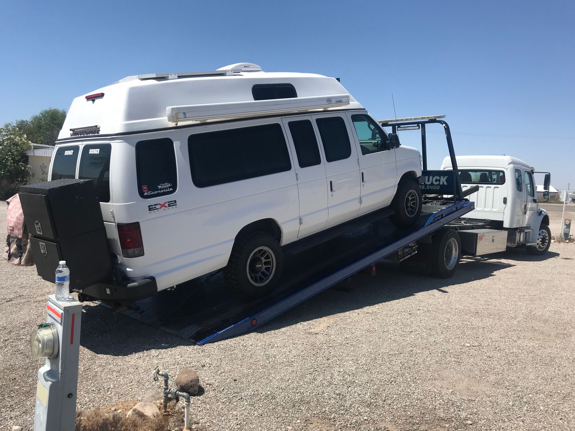

Recently, while running 85 MPH on the highway, my 2012 Ford E350, 5.4, 4R75E, 100K mile van acted like it slipped out of gear for a few seconds, then it returned to normal, only to slip out of gear again for a few seconds. By this time I was on the side of the highway coming to a stop. As I came to a stop, the engine died. After stopping I tried to restart and it wouldn't turn over. Acted like either the motor or trans was locked up. But the motor wasn't overheated. After 45 minutes sitting there, it would turn over a half turn or so, then stop again. Battery tested fine.
I got towed off highway. The next morning it started fine, motor sounds great, but now has a loud knocking sound coming from the bellhousing area. Sounds like a rod knock, but oil pressure is normal, and sound is definitely coming from bellhousing area. Knocking goes away as it warms up, until I rev it up, then it comes back. Van pulls itself forward and backward. Did not attempt to drive it further than a foot so don't know if it shifts. But it's idling lower than normal while in gear, barely fast enough to stay running. Only let it run for about 3 minutes before shutting it down. Assuming catastrophic failure within trans, and/or torque converter.
