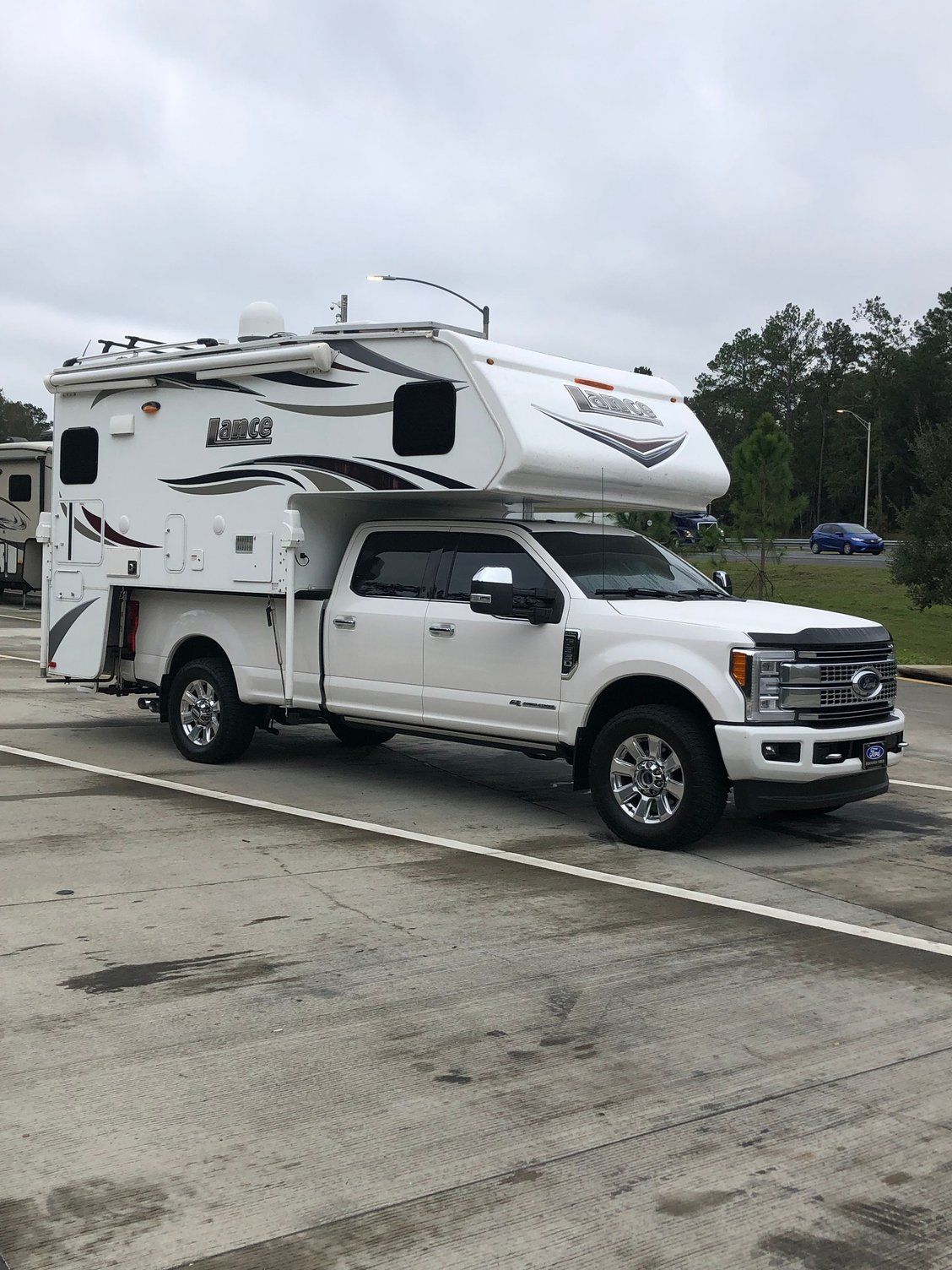

I installed the Hellwig Bigwig on my 17 and it made a big difference in the rocking when loaded and mine is a tall camper.
