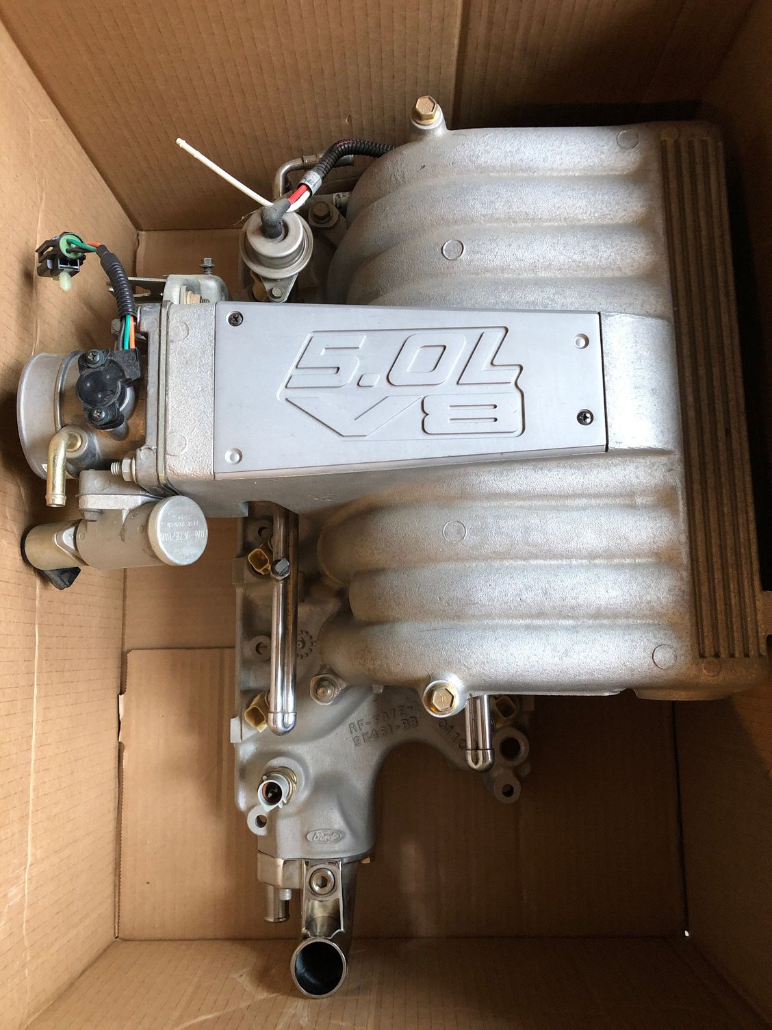

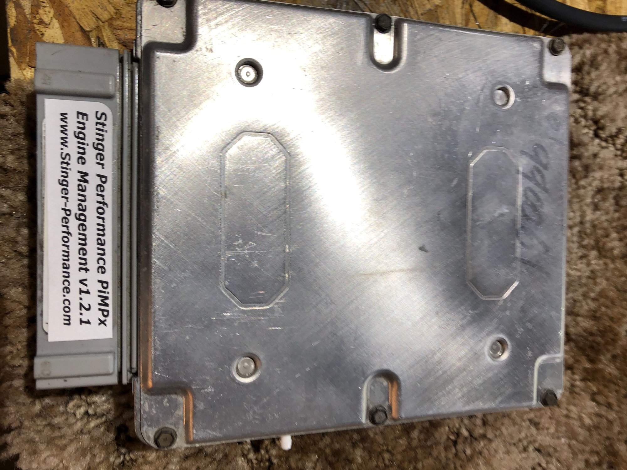

Where are the pic, I’m using the stock 5.0 SD and trying to get it to run on pimpx ECU learning curve is hard for me so far but
Just getting started. I was going to try a Mustang mas air but though this would be less electric, I can’t answer that yet

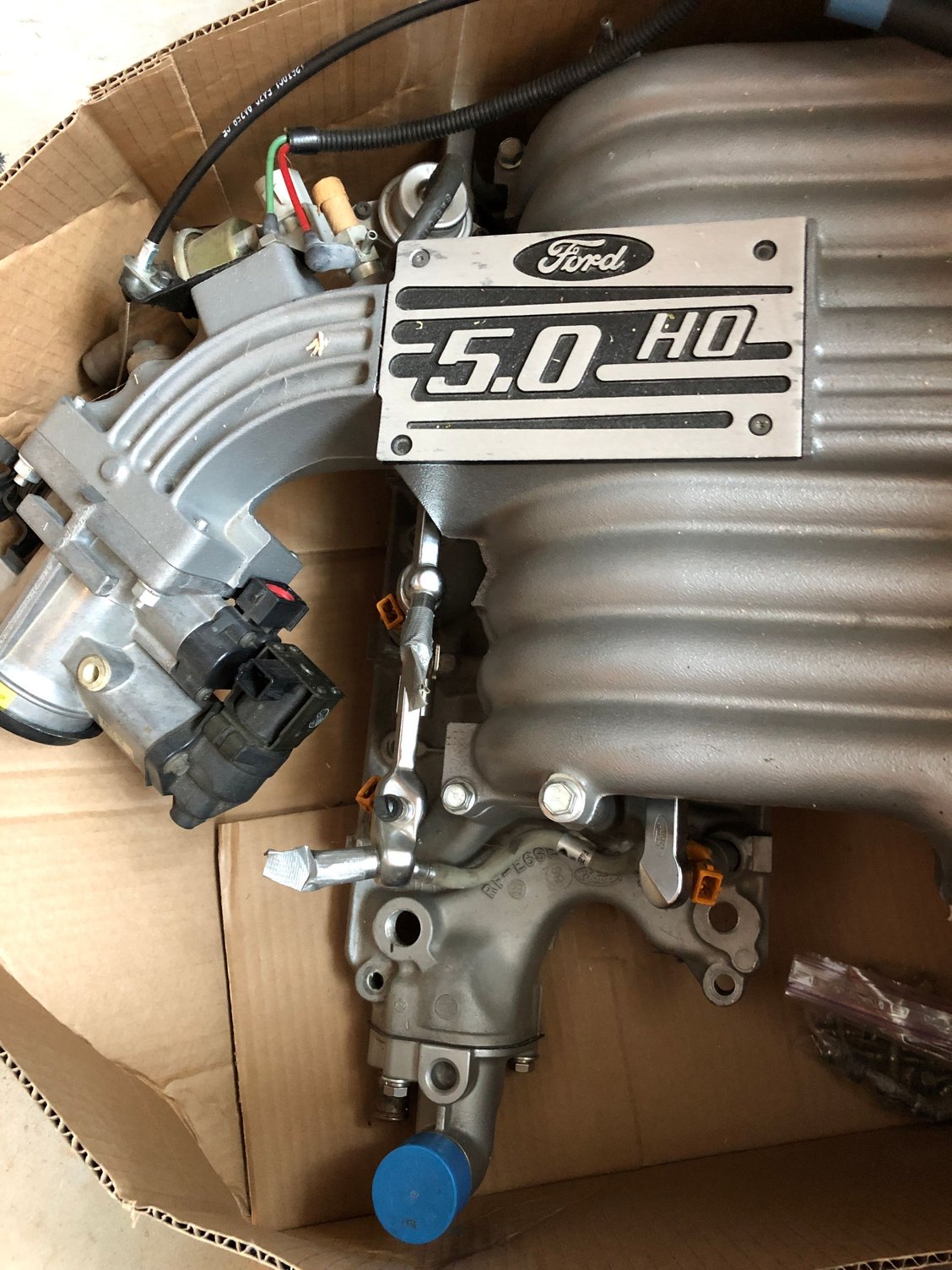

Pic of the Mustang

The explorer manifold
