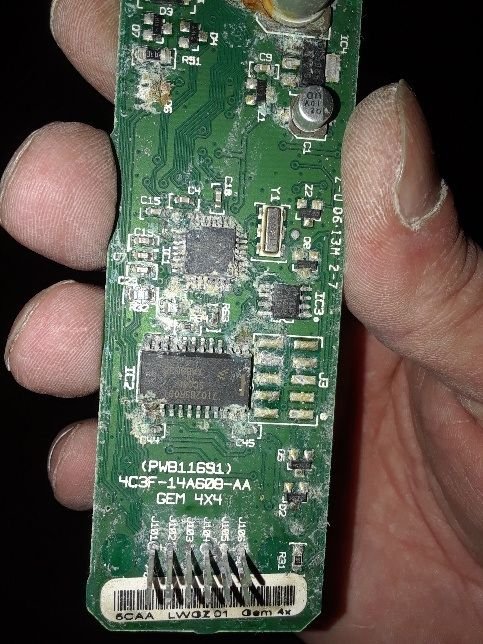

This is a pic of my transfer case shift control module....... Yet on the board it's a GEM 4x4

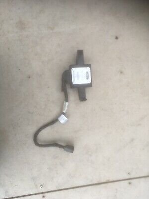

​​​​​​​I think this is the "BCM" ?

Probably a "Salvage" title. That means that the insurance company totaled it for some reason and it was purchased and "repaired", then re-sold with the stained title. Was this a vehicle that was flooded in one of the big storms? The damage to the 4x4 module is clearly from water. If it was a flooded truck, you'd probably be better off pushing it back into the water and leaving it there.
I have no idea what that is in the photo in post #12. I've not seen anything like it before.
As far as the markings on the 4x4 control module, I can only assume that the component manufacturer/vendor used legacy terms in describing what it does since Ford did not use the term "GEM" in their service documentation for the post-2001 Super Duty F-series trucks.

The module you are looking for is probably the smart module behind the passenger kick panel. I am not sure about '07 but my '08 and '09 have one behind there. I know it controls interior lights and other functions including the park lever interlock. The module in the '09 did not work properly and the message display showed doors open, and would not let it shift out of park. Put the '08 module in and everything works fine. This is the module with all the fuses and wiring harnesses plugged into it. I know the '08 to '09 swap worked ok without any reprogramming. Not sure if reprogramming would normally be required though.
