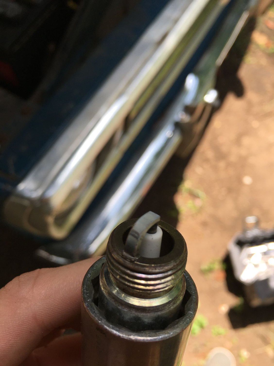

Post a clear close up picture of a spark plug or two. That shows pretty much everything.

anyways here’s plug #1, looks lean surprisingly if I’m reading it correctly. Not wet at all either (also a pleasant surprise to me)

Wow... cylinder #1 has a whopping 110psi.... and yes that was WOT... ouch.
only went up to 117 with oil in it.

Ok I think I figured it out, unfortunately low compression is low compression and I expected that from something that’s sat for 10+ years before I got my hands on it. It’s just a huge bummer as it’s got such low mileage.
Anyways, I advanced the timing to try and counteract the said issue with the balancer and I believe that was the issue as now it doesn’t have any hesitation much at all, and I did a little victory/“test” burnout and it seemed very willing to do so lol didn’t die, didn’t try to or act like it wanted to die, and I even gave it a good bit of throttle and it was fine. I let off the gas and left it in gear to come back to idle and it did so just fine without dying.
Now is is there any way I can increase that compression a few numbers or is it worth doing anything with? Does it matter if I try to drive it with such low compression? Makes sense why it’s got no beans but has plenty of torque still haha.

110 isn't great, but it's not cause for calling the Depression Hotline just yet. Especially, if it hasn't been run for a while.
Did you remove all the other spark plugs before the test? Was the engine warmed up? How did the other seven (7) cylinders turn out? What is concerning is when a cylinder or two is real low relative to the rest, like 75, something like that.
