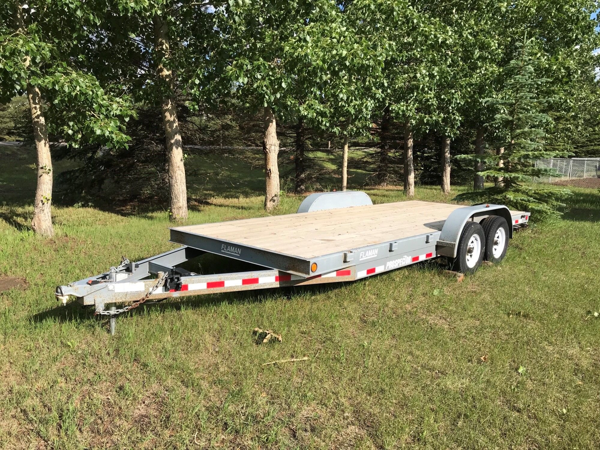

I bought the Arctic Fox 990 instead of the larger versions so I would not have to use a really long extension.
Now I wonder if I need one at all.

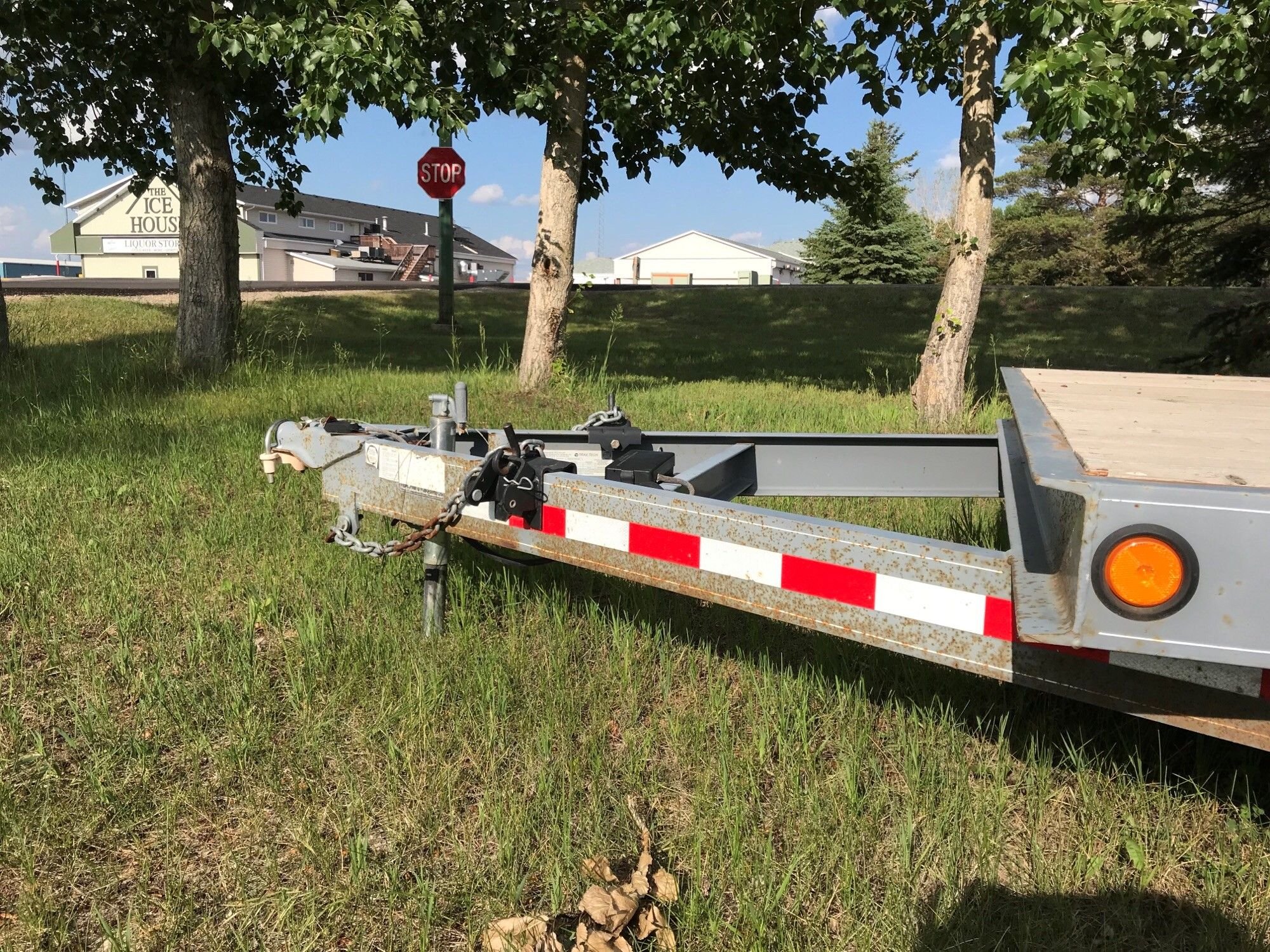

The center of the hitch ball is about 10 inches back from the trailer bumper. The flat deck is low and has a very long tongue. There is plenty of clearance to work the jack and attach the bars. The corner of the deck should have 5 inches of clearance to the trailer jacks if I somehow jackknifed the trailer.
Am I foolish to consider this? I would use this setup once a year to go to an offroad event. The trailer would stay attached until I get home.

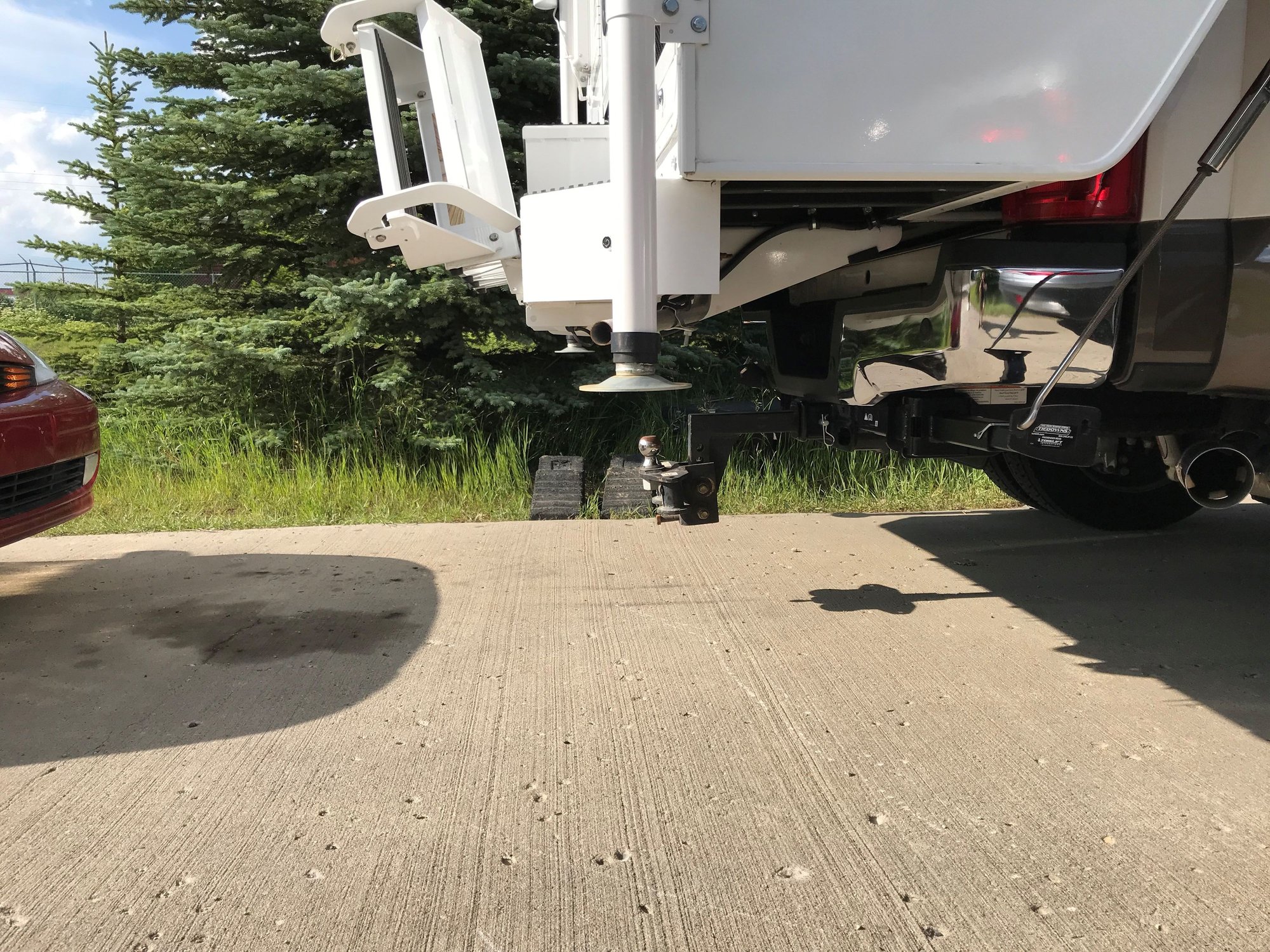

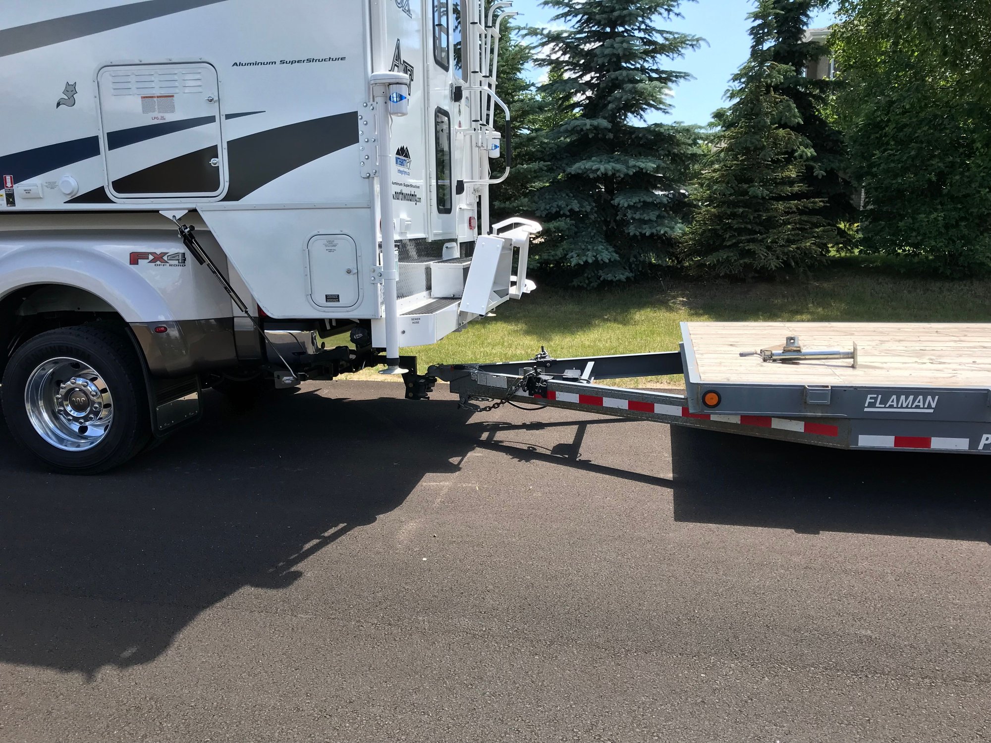

Here it is on the ball. I turned a u-turn as tight as it gets no problem. And U-turns are tight with an F450.
This combo is going to work well. So glad I got the smaller camper.
