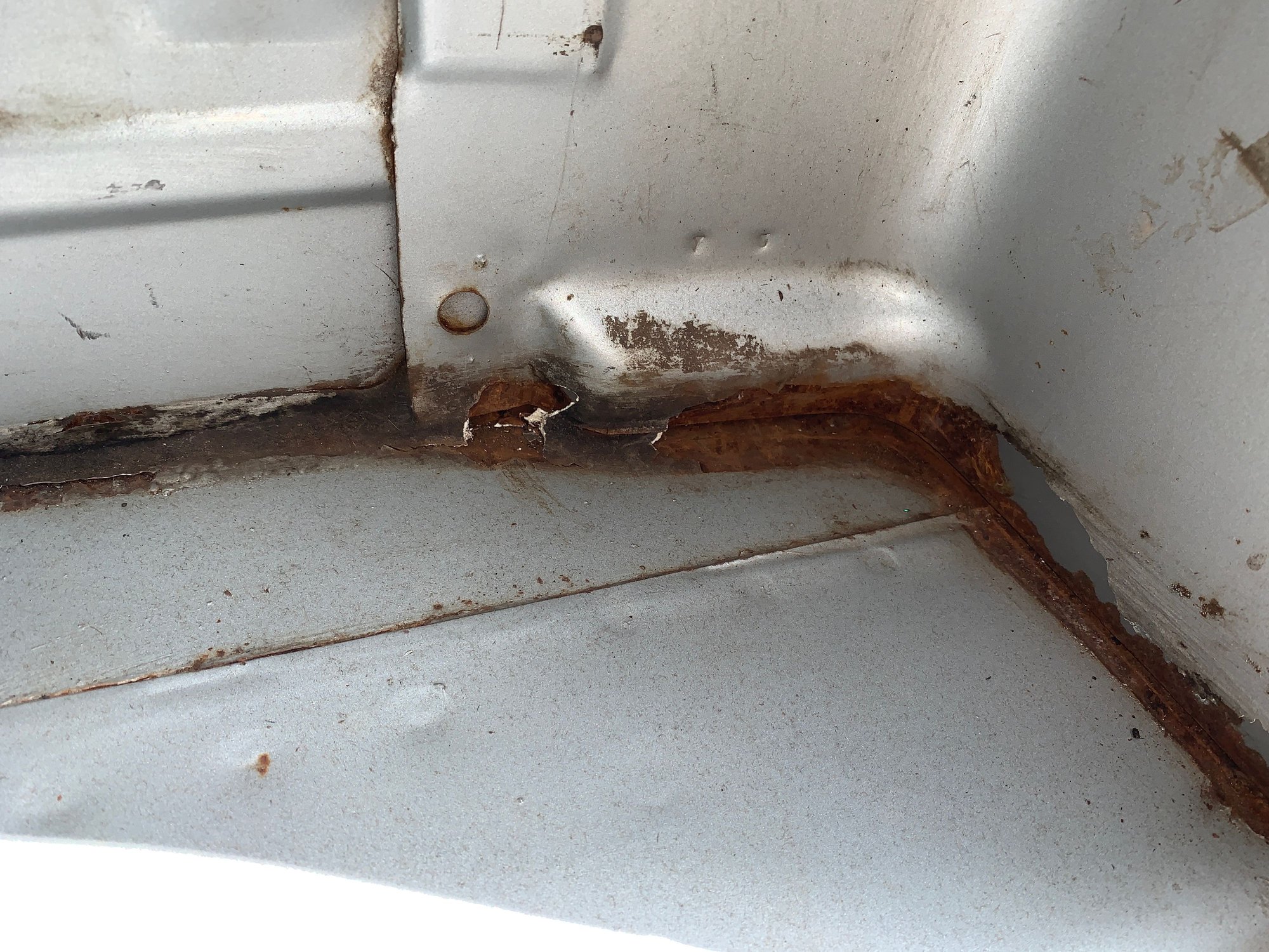

2. At the back of the cab, where the cab floor meets the back wall, is what appears to be a seam seal. But in places its old and cracking and even disintegrated just a bit. I'm able to chisel it out if I want to (as seen in the pic). I'm inclined to go ahead and chisel out the entire seam seal and clean it, treat the minor surface rust and put in new Seam Seal. YES? IF SO, WHAT IS THE BEST SEAM SEAL TO USE?

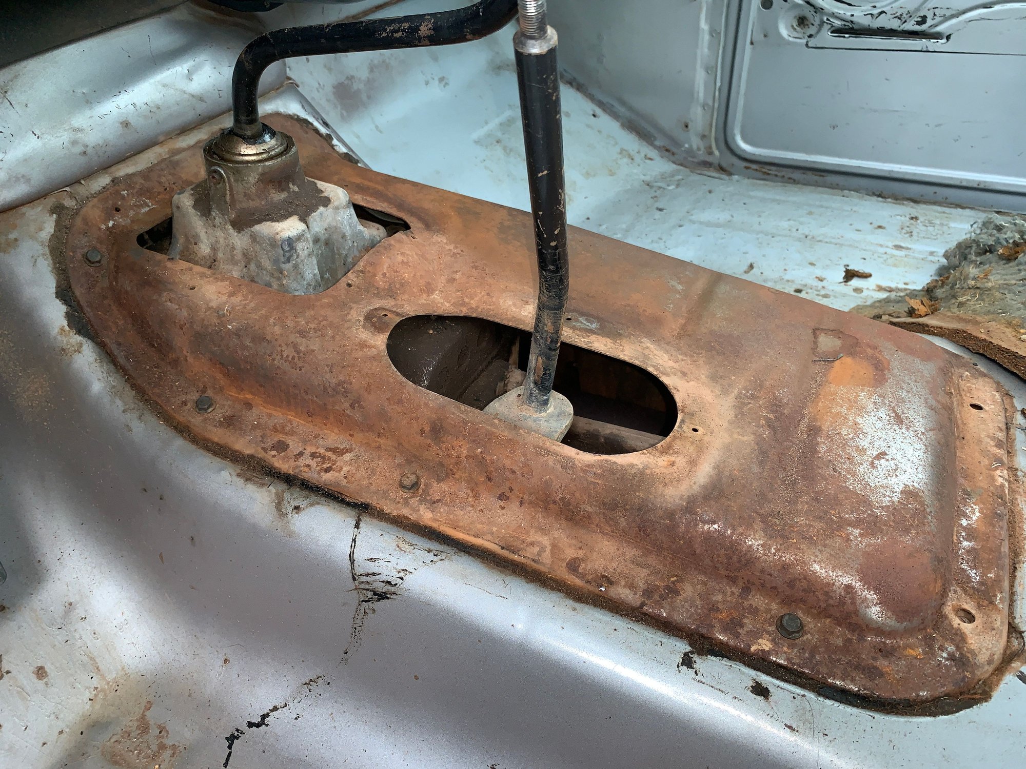

3. When I pulled the shift boots off of the two floor shifters, there seamed to be a tiny bit of insulation / seal under one of them, but it was mostly gone. It just looked like it was there at one time. IS THERE SUPPOSED TO BE A SEAL OR FOAM OR INSULATION UNDER THESE SHIFT BOOTS? IF SO, WHERE DO I GET THEM...I CAN'T FIND THEM IN ANY DIAGRAM ANYWHERE.

I pulled the carpet out of my truck because it was moldy and stinky. It wasn’t the factory carpet but the black gunk the PO used was really similar to the seam sealer used elsewhere.
I think I used paint thinner and a grinder with a 4” or so wire wheel. I rolled bed liner in my floors so I had to get it clean.
Wipe on thinner, wheel spot, wipe again. Be careful not to fling the hunk. Be prepared to throw your wheel away. I used grinder in one hand and cardboard in the other to block what little spray there was. But be careful like that.
I have no help other than that.
