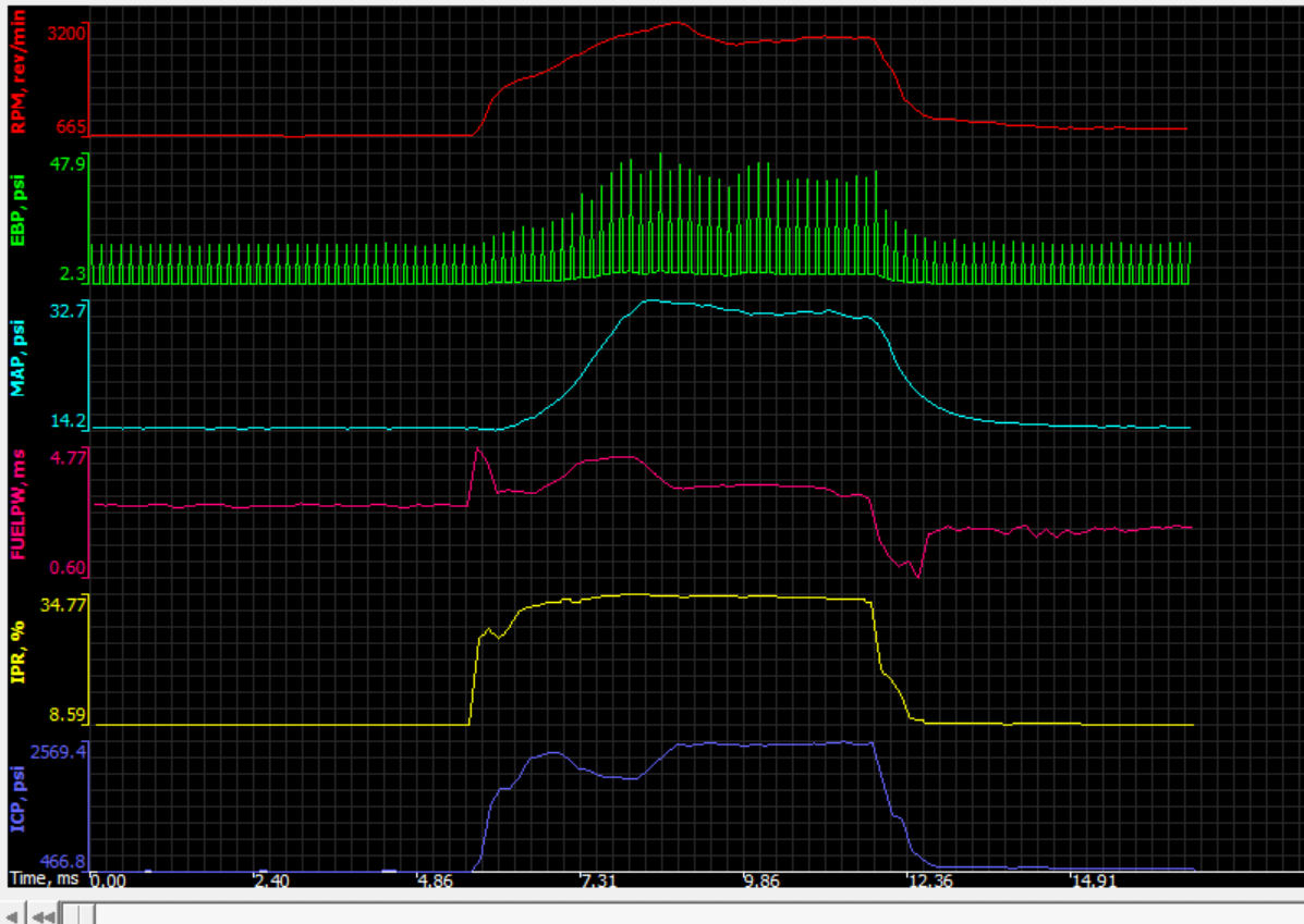

I did not get a chance to make any WOT pulls today or look for boost leaks due to attempting to clean the oily mess from a busted HPOP hose a couple of weeks ago. However, I did get to drive around the neighborhood (25-40 mph) monitored what i could. Attached is a graph from forscan the spike from just off of idle to 1750 or so rpm did produce a nice plume of black smoke. The following rise in rpm also produced a bit of black smoke but, barely enough to see in the mirror. Overall the smoke seems to be steady when sharply increasing throttle until the turbo catches up.
If there are any other parameters I should be monitoring please feel free to let me know.

Your ebp reading looks off, it shouldn't go below about 14.7 since that is atmosphereic pressure, try cleaning the sensor and tube out the sensor could be bad too. Also going by your map sensor you only maxed out at 3-4 psi of boost that whole time.

If he was only giving it partial throttle up to 40 mph then it probably only was making 3-4 psi and that would seem normal I think. I am guessing the turbo is probably fine if it was recently rebuilt like he mentioned. The EBP sensor and tube might be part of the problem. When I took mine apart a couple years ago it so coked up with carbon inside the sensor that would not budge that I knew that replacing it was the best idea. Also the tube was not holding pressure at all because of a big crack in a rusted out spot on one of the bends. What is the EBP sensor show for a reading with the truck just idling when you go to the panel view that just shows the numbers instead of the graph view? If the sensor is working it should follow the MAP sensor reading pretty closely which should be right around 14-15 psi at idle which is just atmospheric pressure (no turbo boost)
Beyond that my money is on pressurized leaks in the charge air circuit and possibly also the pre-turbine exhaust side. On an engine with that kind of mileage on it it would not surprise me. Tuning up the fuel delivery system might have agitated the problem by restoring optimal fuel pressure to the injectors.

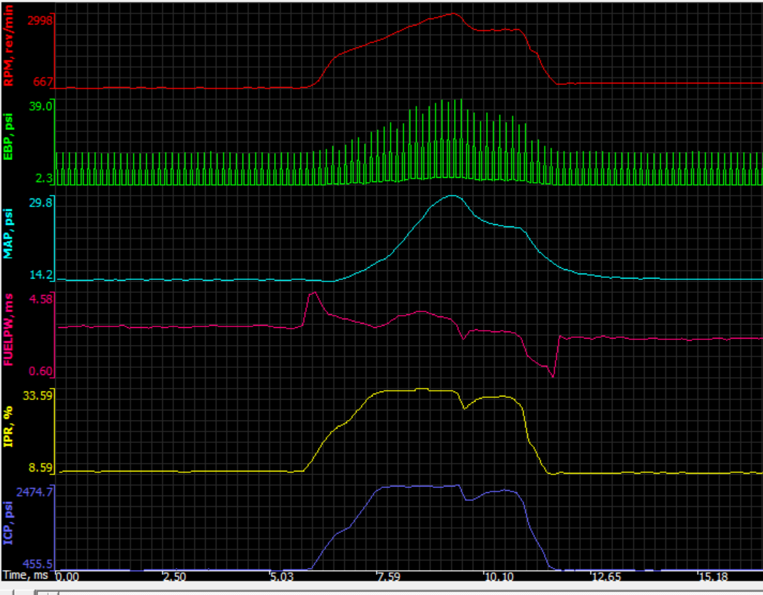

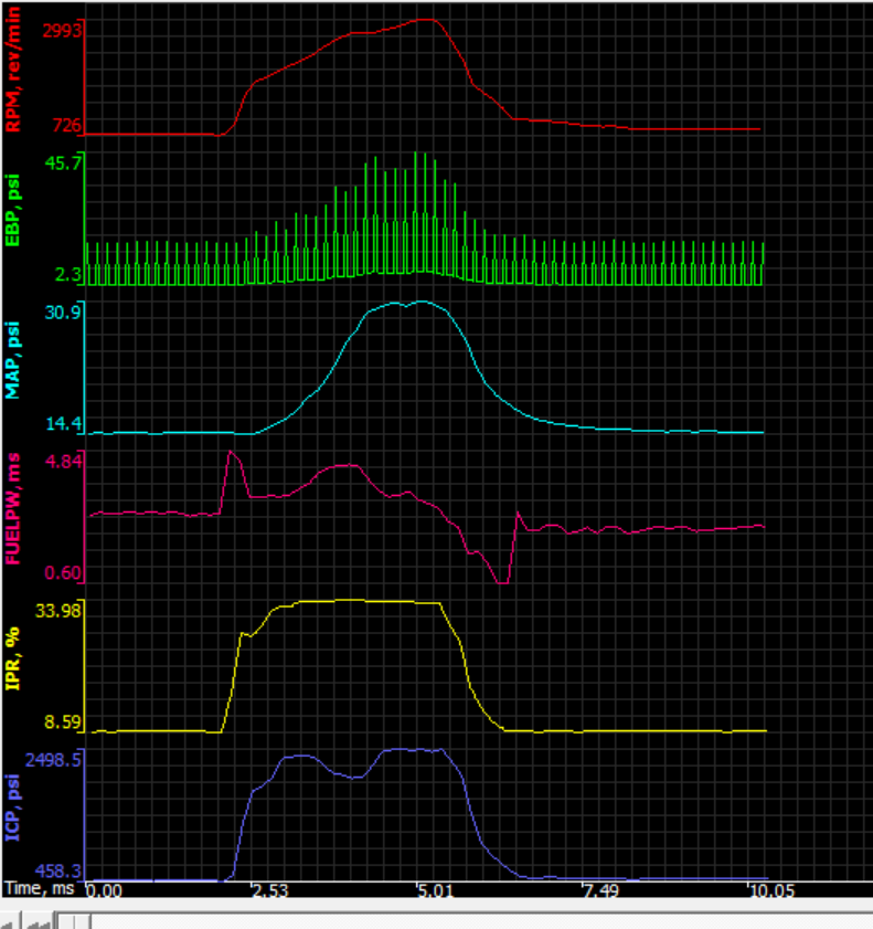

Got a chance to make a few runs at WOT throttle today, driving around to warm up beforehand it did not seem to be smoking as much as it had been, kind of like its back to normal.
During these first two it did not seem to smoke too bad granted, I was only at about 80% throttle.
The last couple of times I was foot to the floor from a dead stop.
Both the MAP and EBP sensors seem to be working properly in my opinion.

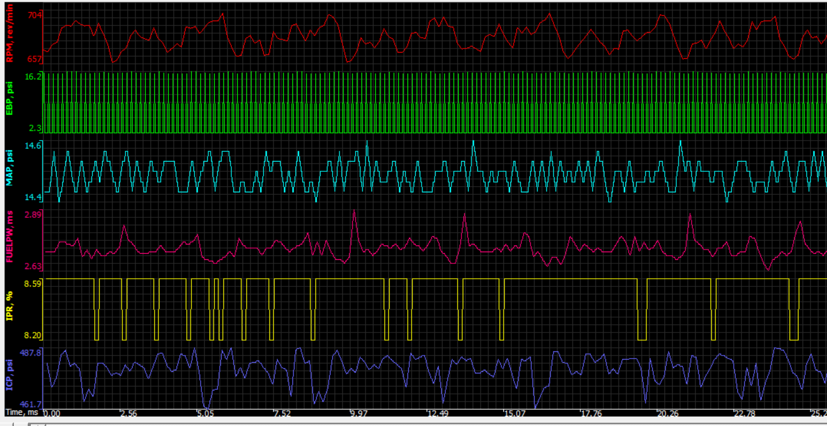

And here is idle shortly after
I'm not sure what is causing the variation in idle speed, any ideas on that would be appreciated as well.
