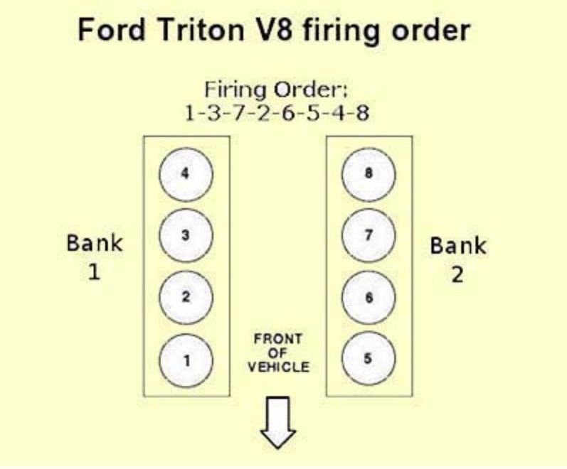

Okay I know you probably have the right one, but just to be sure...how many cylinders back and on which side are you giving this attention to?
No worries---better to ask than "assume" huh? I'd do the same.........
#7 is drivers side (Bank 2) third one back from front, like this:
