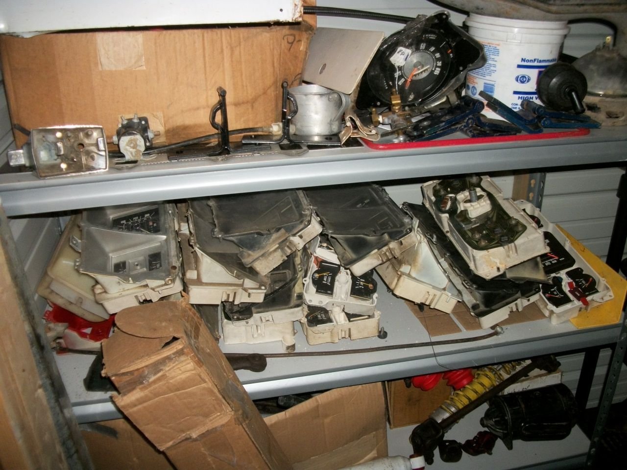

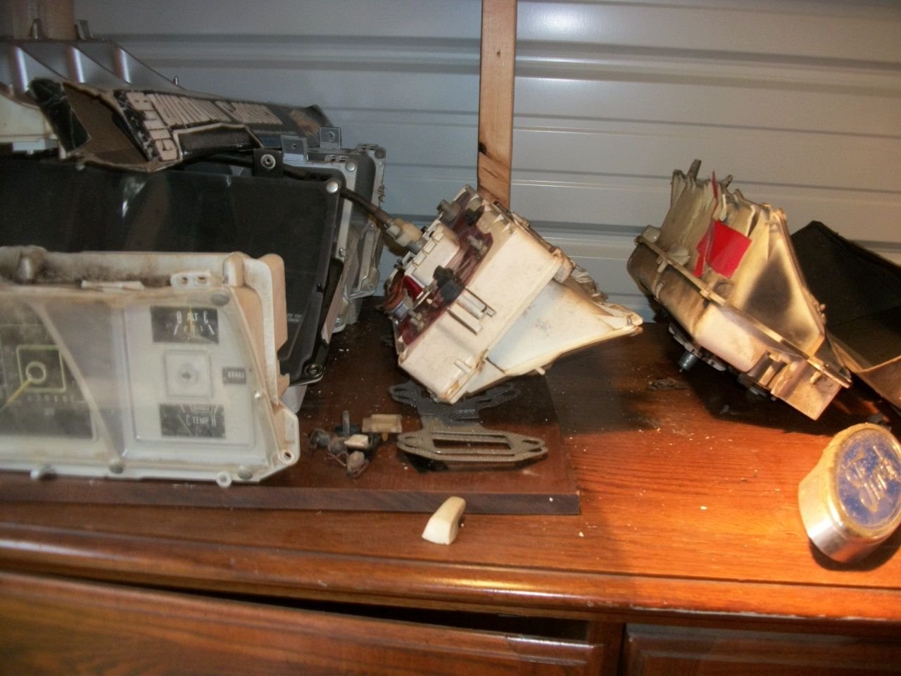

I have a few spares and spare parts. But I am currently on the road working for a while. I would let you probably have some parts to fix yours for the shipping cost, plus a buck or 2.

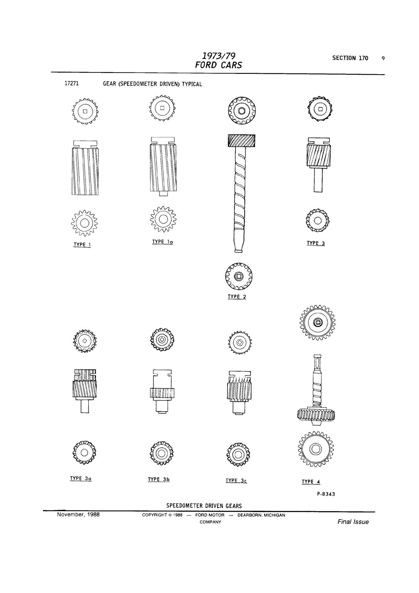

Speedometer driven gear color and teeth count.
