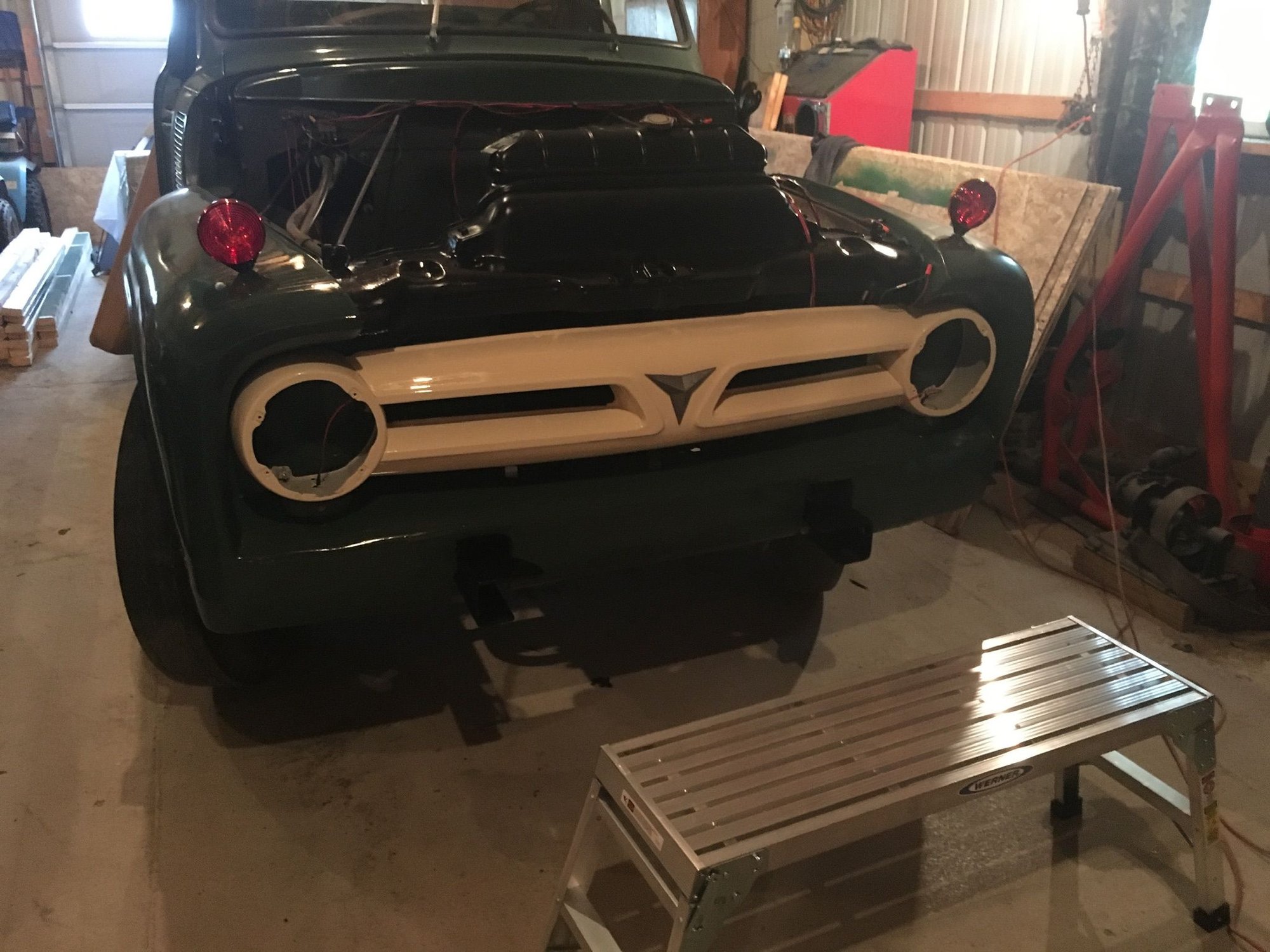

Primed the grille this morning. Color coated this evening. I’m going to have to strip it all off. It’s all bubbly. Like the primer and the paint don’t match. They are supposed to be both acrylic enamal. Dosent say it on the can if it is it not. I know they tried to sell me urethane reducer. I caught that and had them switch it. Color, reducer, and hardener all seemed to mix well. I don’t know what’s going on.

Acrylic enamel is not that common anymore , more acrylic urethane but if your reducer and hardener are proper then it shouldn't have been a problem . Did you force dry or just air and at what temp ? Could you post a pic ?

Good use for an old tent.

I love it!
Old Jun 17, 2019 | 11:26 AM
Mixer man's Avatar
Mixer man
Joined: Sep 2014
Posts: 4,920
Likes: 21
From: Bothell & Silverdale, WA
Looks beautiful!
Old Jun 17, 2019 | 02:14 PM
abe's Avatar
abe
Joined: Dec 2000
Posts: 25,405
Likes: 5,411
From: Central PA
Looks great. I love that color combo.
Old Jun 17, 2019 | 02:34 PM
rusty48's Avatar
rusty48
Joined: Feb 2016
Posts: 359
Likes: 32
From: washington
Had similar issues with several different materials. If first coat is not fully flashed and cured, coat # 2 will bubble or crack, and if using a clear over color same thing. yea I pushed it to fast and got to enjoy the sanding process again.
