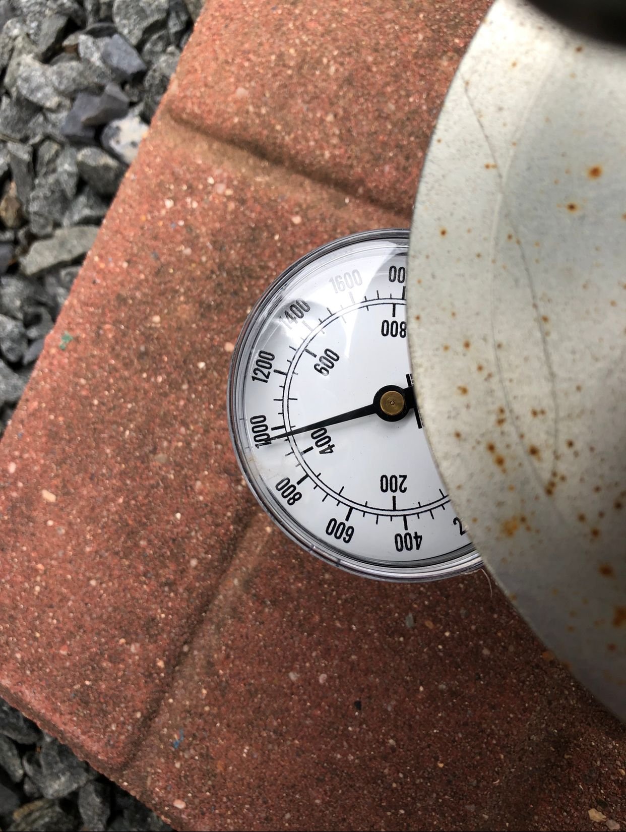

Truck / Trailer specs are in my signature...my concern is while towing on the freeway (above 50 mph) the trailer starts to get a little squirley / dancing in the lane some. I find myself constantly making subtle adjustments with the steering wheel to compensate.
I weighed my TT and it came to 7,100 lbs with about 950lbs tongue (~13%). My dealer set me up with the BlueOx SwayPro 1,500 lb WDH. Would moving to 1,000lb spring bars make any difference?
I'm not sure what to adjust, but coming home this past weekend after 2 hours I was exhausted. I have a 8 hour trip coming up in July so I want to try and have it better dialed in by then.

I think that is because when the trailer was unhooked the tongue and axels were both on the weigh plate. When hooked up the 1,000lbs of tongue was transferred to the truck axel.
I also figured out my tongue scale is reading accurately based off the CAT readings on pass 1 and 2
DA: 3,840 - 2,540 = 1,300 lbs.
SA: 3,300 - 2,940 = 360 lbs
1,300 - 360 = 940 lbs which aligns with my tongue scale.

So based on my 950lb tongue am I better off with 1,000lb bars or 1,500lb bars? Keeping in mind the trailer was only loaded for a weekend not a week long trip.
That's a good question and I would be inclined to go with what Blue Ox says. My thought was that if your spring bars are too stiff (1500 lb) then you simply don't connect them as tight. On the other hand, a spring bar that is too light (say 700 lbs) can be tightened only so much and they you're out of adjustment.

I have a similar set up and had previously been using the 1500lb bars for my F150 because of it's low payload. The F250 handles the load much better so I moved down to the 1000lb bars. I have 8 links in with 3 1/2 showing when hitched up. You are exactly right and so is Blue Ox...you want the added deflection because this is the fundamental basis for how the hitch controls sway. My tongue weight is 900lbs. Go with what Blue Ox recommends and enjoy a better ride.......
