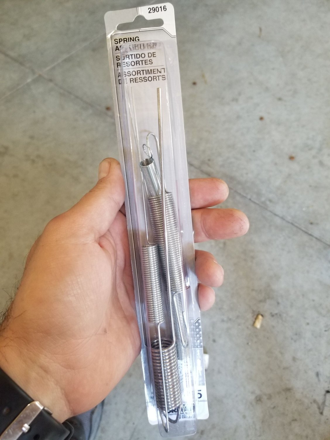

Was it by chance this one?!
I went to about 5 more auto parts stores today and 3 fleet supply stores, and finally found this pack at a Pep Boys. I think I'll be able to make something out of this to work! Every other store I'd been to previously only had throttle return springs, which are way too weak.

it was similar to that, if that's not it. I think I used the smaller one.

I'm about to get under the truck in a minute and see which ones works best. I know one thing though, whichever ones I dont use are going in the glove box as spares in case I have that spring break going down the road with how my luck goes ha.
