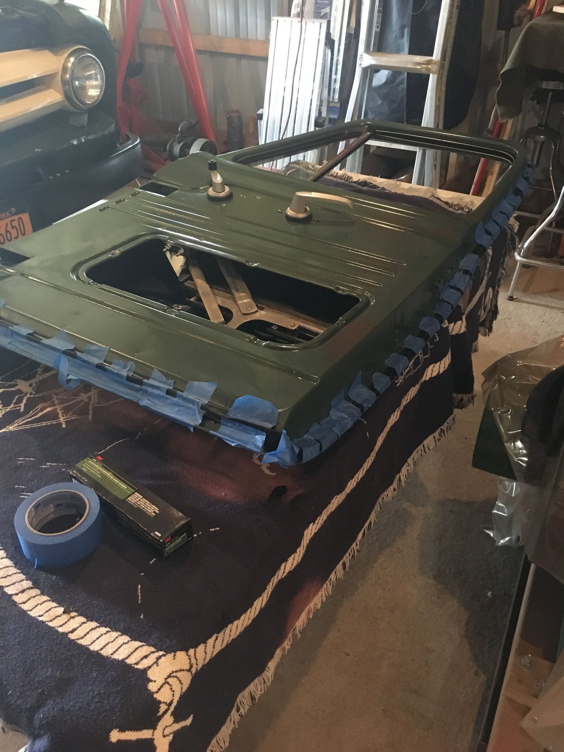

Probably overkill with the tape, but hopefully the rubber seal stays in place.

Yeh, that's overkill. You used 3M black adhesive, right? You probably didn't need any tape. Did you squeeze the door bottom retainer on to the rubber? You should be OK.
Aren't you glad you did it with doors off the truck?
