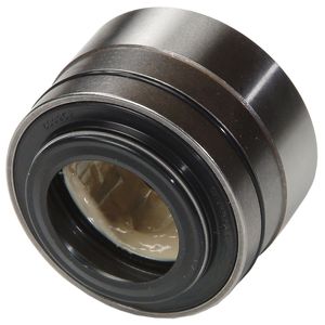

The parts stores sell repair bearings for that situation. Autozone part number RP-6408. Looks like it offsets the bearing to a different spot on the axle.
